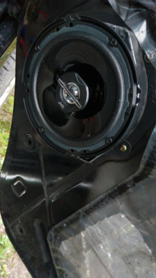

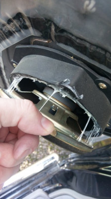

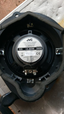

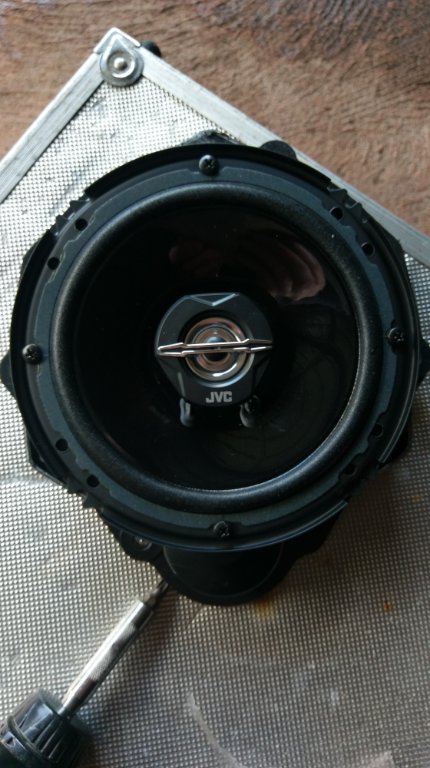

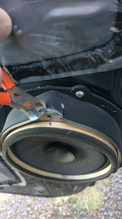

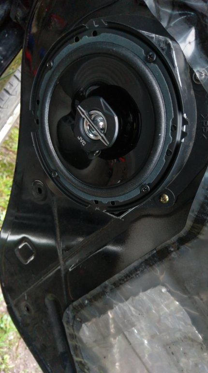

These JVC CS J620X speakers will fit straight in using the original mounts, just trim the plastic around the speaker, remove the screws and pull the speaker off. Trim it flat and fit the new speakers. They are pretty good speakers and only £20 🚐

Them JVC speakers is what I used, I got creative when fitting them.
A recommendation after fitting them would be to use some spongy stuff around the front end to create a seal with the door panel otherwise the bass is horrendous.

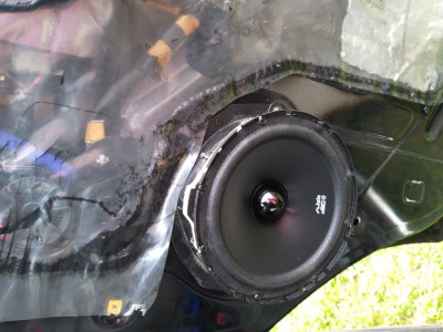

If you want bass go for the Vibe Slick 6c v7 Components which require a 10mm spacer and the bolt behind being changed 🚐 but they are awesome speakers clear musical and loud 😎 and move some air

In addition, if those are the original Mazda speakers in the photo with the cutting tool, mine are quite different. Could be they’d been replace back in Japan before she arrived in UK. Anyway, let the head banging resume....
