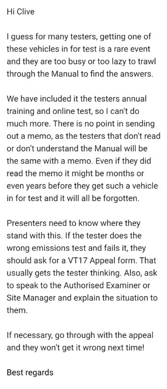

DVSA have taken note but sadly lots of MOT testers aren't
my Winniebongo has been subject to a full CAT test last two years as my testers say they can't do it without a CAT test ![🚐](//cdn.jsdelivr.net/gh/twitter/twemoji@latest/assets/svg/1f690.svg)
![Crying or Very sad :cry:](./images/smilies/icon_cry.gif)
- g8dhe
- Posts: 10268
Re: Diagnose more V6 emissions? (CO,but Lambda seems fine) DON'T DELETE
Perhaps try a different Testing Station ?
- Mrs Feynmans Bongos
- Bongonaut
- Posts: 45
- Joined: Mon Apr 06, 2015 10:49 am
It seems to me unfamiliarity with this scenario is leading certain Testing Stations to "cover their a*se" by ALSO insisting on a Cat test.
(Perhaps understandable, given DVSA impose penalty points on Stations for "Irregularities", too many & they lose their Cert. ie livelihood).
But if they read the extracts from full DVSA guidance I posted above (including flow diagram), read it and understand it, they will see that NO Cat test in addition to "Minibus emissions" test is required, ie they have invented that bit.
Of course trying another Station (as Geoff says) may be easier than trying to walk an Expert-Sceptic through all that DVSA blurb.
Good luck, do let us know how you get on.

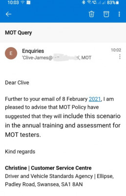

DVSA have tried to do as much as they can as the latest reply shows ![🙄](//cdn.jsdelivr.net/gh/twitter/twemoji@latest/assets/svg/1f644.svg)

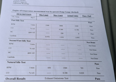

Hmm, this year MoT station merely gave me a "NON-CAT VISUAL CHECK":
![Image](https://i.postimg.cc/NMqMtLVk/IMG-20210821-124546141.jpg)
Whereas last year, when I justified use of "Minibus limits", same station gave me "NON-CAT METERED CHECK":
![Image](https://i.postimg.cc/bwZN2QfR/IMG-20210821-124610987.jpg)
After having first failed it on "CATAYLST EQUIPPED WITH CLC":
![Image](https://i.postimg.cc/DfWT67M2/IMG-20210821-130448413.jpg)
Only 12 days ago, so reckon I'm going back to demand a full CAT-TEST but with MINIBUS LIMITS (which I thought I had, grrr)
Thanks again, such a helpful lot on Fury!

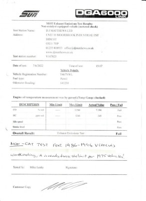

So, My V6 Petrol also failed on one thing at his yearly heath-check. Seems to have gaseous emission problems - much like his owner.
It had a mini service when I got it in June last year comprising of new plugs, new HT leads.
I fitted a new air filter in April this year where I also cleaned the MAF sensor.
It had a cambelt service about a month ago where it also had an oil change, oil filer etc.
When it failed with such a big reading I fitted a new Lambda sensor, no change even when nice and hot. (I have a little Gunson gas analyser which gave the same reading as the MOT station).
Any suggestions on where to head on the diagnostic trail next ? All input welcome.....
Stripped the airbox off to inspect the flexi pipe, clean the MAF sensor and its plug again today.
Ran the gas analyser after getting it nice and hot.
Fast idle it shot up from 2.0% to about 7.1% - 7.4%, when throttle was lifted it dropped down to about 2.0% again - which is a pass for the non-cat test (3.5%). Whilst stood there scratching my chin and wondering what to have for lunch, about 15 secs later while idling it jumped up to around the same 7% reading. This is odd, because it runs like a dream, alway been silky smooth, never smokes,never loses any coolant. With a jump like that on idle I would expect it maybe to hunt as its over fueling, but nothing, just the O2 reading worse than a cow thats been out for a vindaloo and 20 pints of lager. Got a new cat coming on Tuesday. Will see if that helps.
