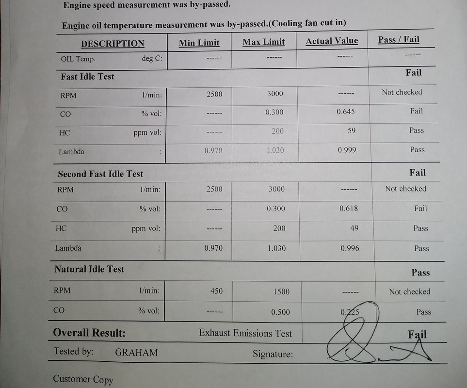

My V6 has just failed MoT emissions: "Exhaust carbon monoxide content after 2nd fast idle exceeds default limits [8.2.1.2(b)]"
I'd hugely appreciate any advice the lovely gurus here can offer, by way of clues/methods to suggest to my mechanic?
(it's booked in for 17/8, not a Bongo specialist but content for me to source parts even perhaps in advance, depending of level of certainty :D )
Here's the readout
It was "warm" after 20 miles to work +same back, both ways held in 3rd for 10 miles, with plenty of "Redex" in the tank. New cat 2018 from AutoJap.
Given HC and Lambda both passed, MoT garage said no point trying their "BG 44k" fuel system cleaner (this helped last year after it failed while ~cold)
Strong smell of petrol from the exhaust led them to suggest looking for failing INJECTORS.

My emissions readout states max limits "200 ppm Vol", "0.3% Vol", for HC and CO respectively.
If you are saying the limits should actually have been 1200 ppm, 3.5% respectively, it seems it should have PASSED!
Whereas if readout would in fact quote 3.5% limit as "0.35", then my CO readings 0.645, 0.618 still FAIL.

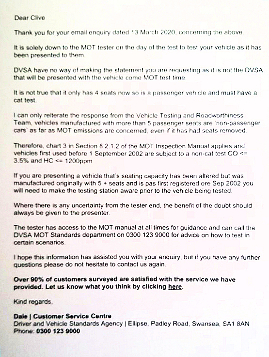

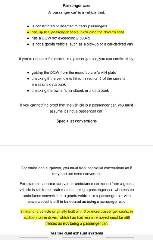

Yes as all Bongo's and Freda's are imports and have cats as standard but as they were made with more than 5 passenger seats they are not classified as a passenger car by DVSA
There is a PDF on it here

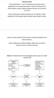

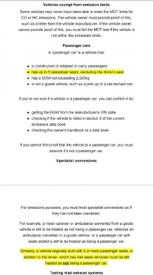

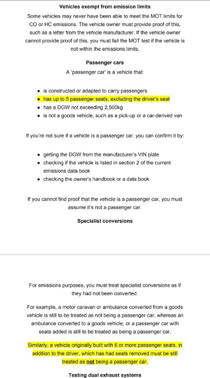

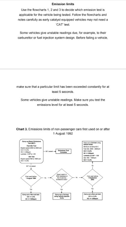

I told my MoT garage the result of my cry for help here, that basically because it was manufactured pre-2002 with 8 seats, it classes as a "non-passenger vehicle" for emissions and, because it is not listed in DVSA's "In-Service Emissions book", a "non-Cat test" with far easier limits applies.
I walked them through all, especially Chart 3 from MOT inspection manual for private passenger and light commercial vehicles
(wherein ?most Bongos land in the lower-right box) and the absence of Bongos from pp97-99 of DVSA In Service Exhaust Emission Standards for Road Vehicles 19th edition (presumably because never marketed in the UK).
They will retest my emissions at 4pm today, so fingers-crossed ...
So grateful to Bongolia and Doone/Allan ... this may save me £'00s [-o<

From Royston's PDF

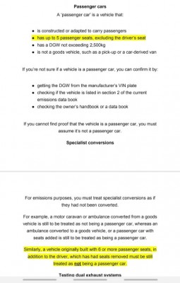

Post by Winnie-bongo » Thu Aug 13, 2020 4:20 pm

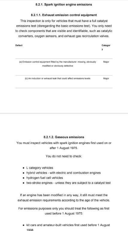

Page 2
Winnie-bongo
Posts: 59
Re: Diagnose more V6 emissions? (CO,but Lambda seems fine) DON'T DELETE

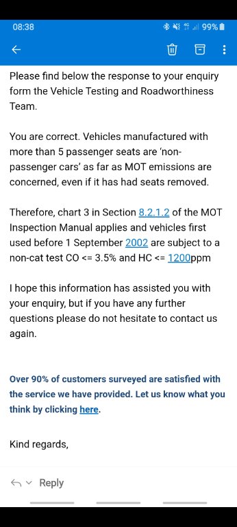

Post by Winnie-bongo » Thu Aug 13, 2020 4:21 pm
Page3
Winnie-bongo
Posts: 59
Post by Winnie-bongo » Thu Aug 13, 2020 4:22 pm
Page 4

The link I posted above for a PDF on petrol Bongo or Freda emissions has been updated with my replies from DVSA and as I can't edit the post I am having to put it here.
I have pointed out to DVSA that testers don't seem to understand and DVSA are now hopefully including it in annual training and assessments for testers
