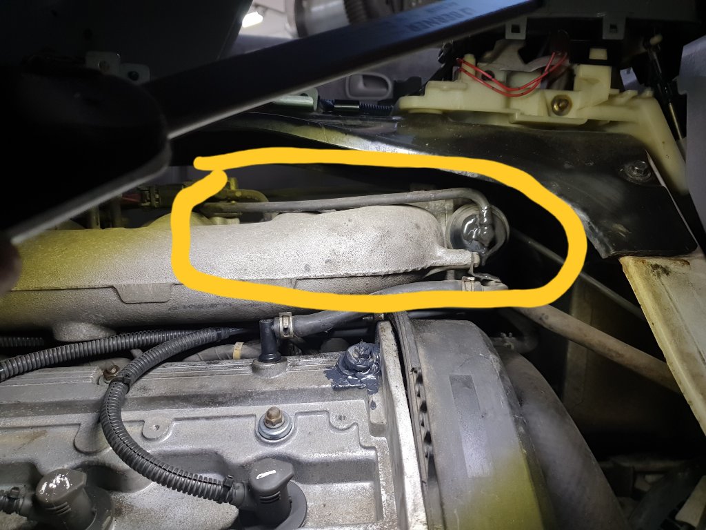

Helpful Mazda mechanic replaced the front fan motor and bypassed the air intake membrane/sensor (see pic) that was previously glue repaired and faulty(apparently). He thought this membrane sensor had caused the original issue so sent us on our way.

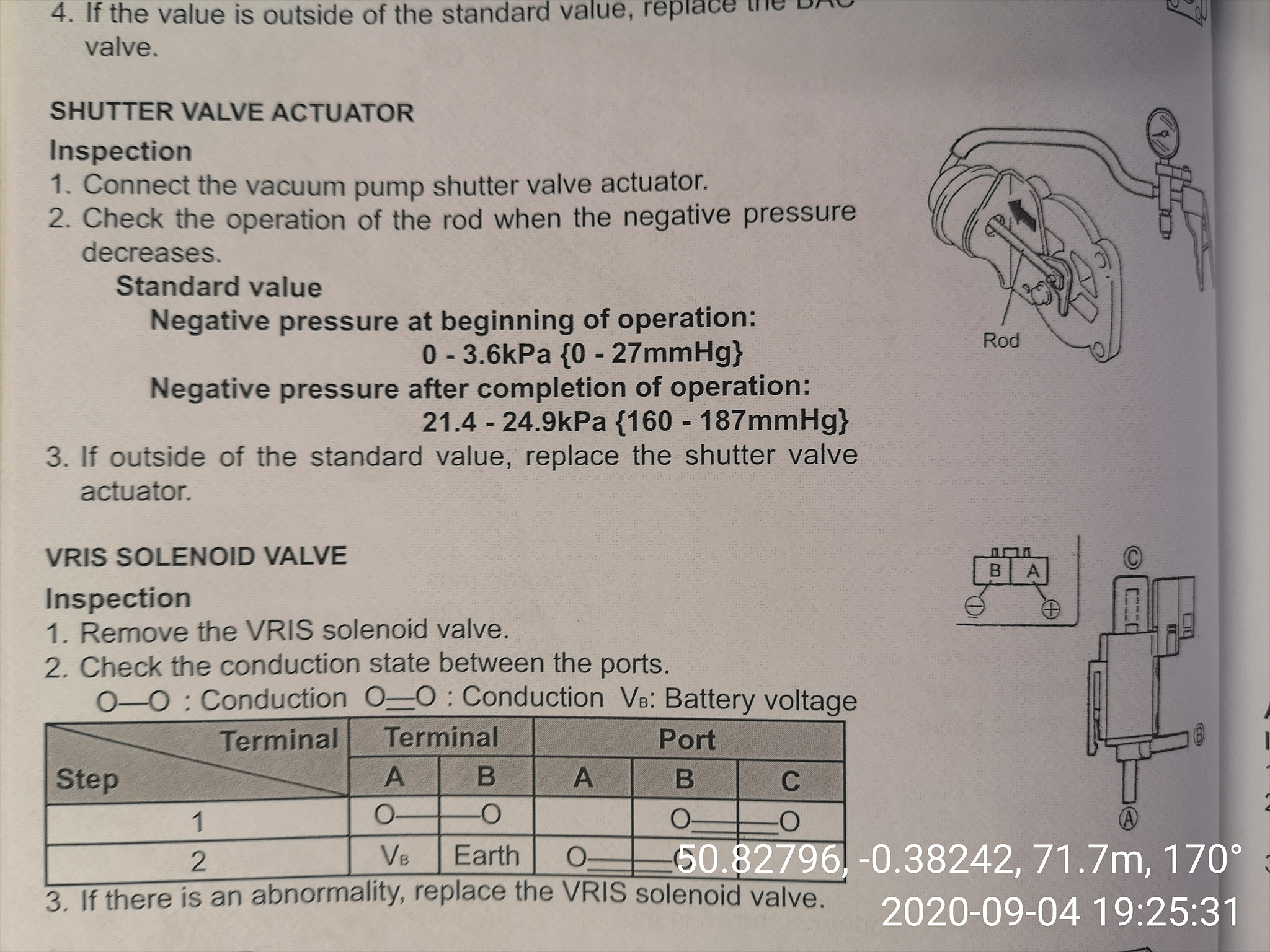

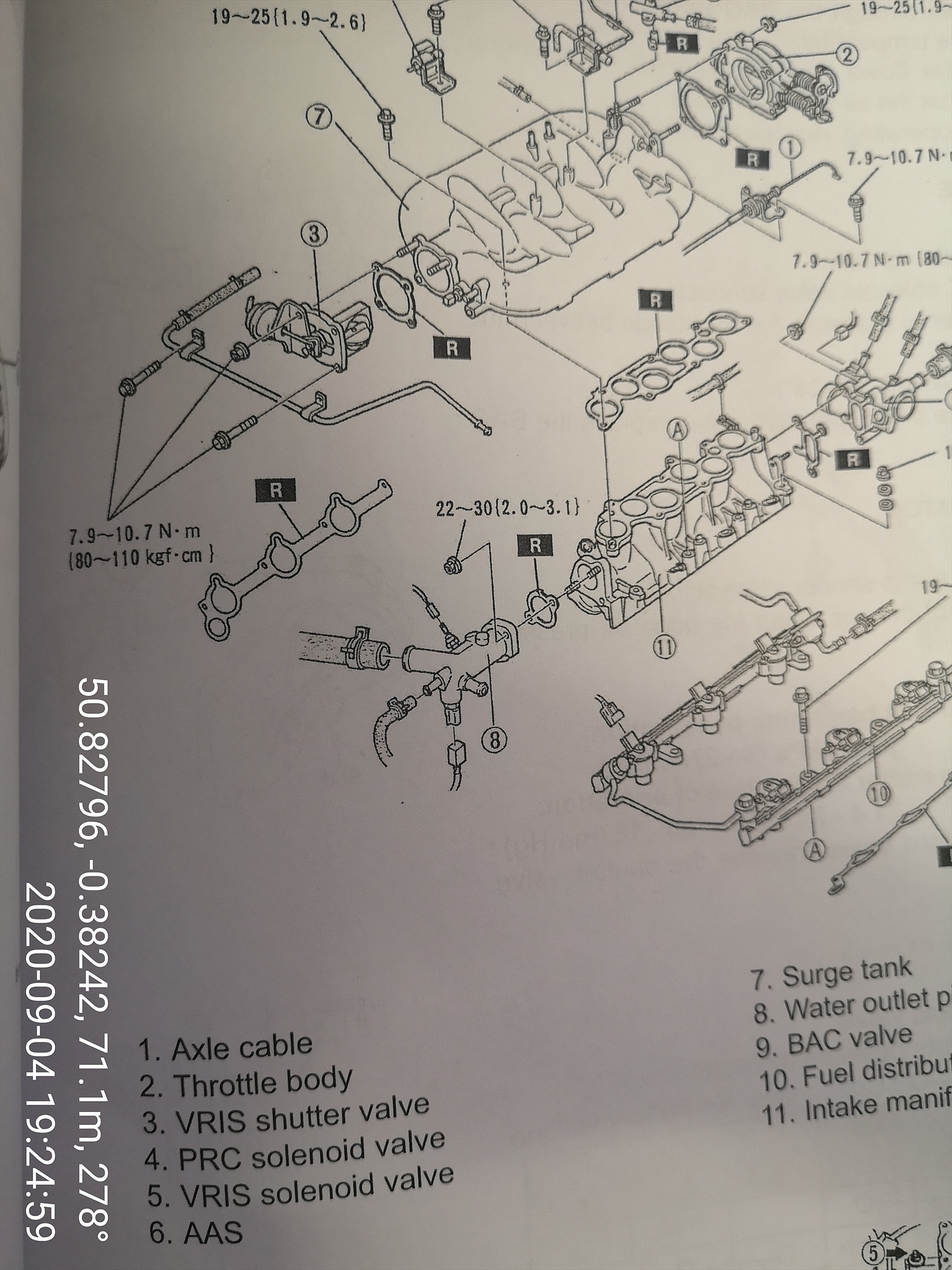

Ah I believe that is the Variable Resonance Intake System (VRIS) shutter valve operated by the vacuum system. There is a diaphragm (Membrane ?) that pulls a rod to adjust the engine air intake mechanisms.
Re: Bongo Breakdown (Paris)
The part number for the shutter valve is J50320150A.

OK I would have called that a swirl flap actuator. I dont know if this one defaults to a normally open or normally closed state but you could try disconnecting & blanking the vacuum pipe then physically jamming it either fully open or closed (depending on which way around it operates). Secure the arm/rod with cable ties or tie back with wire etc.
