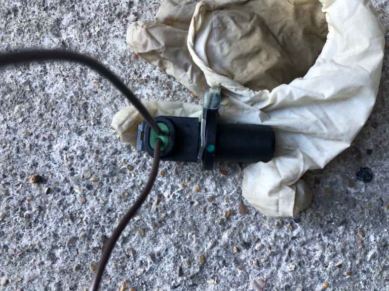

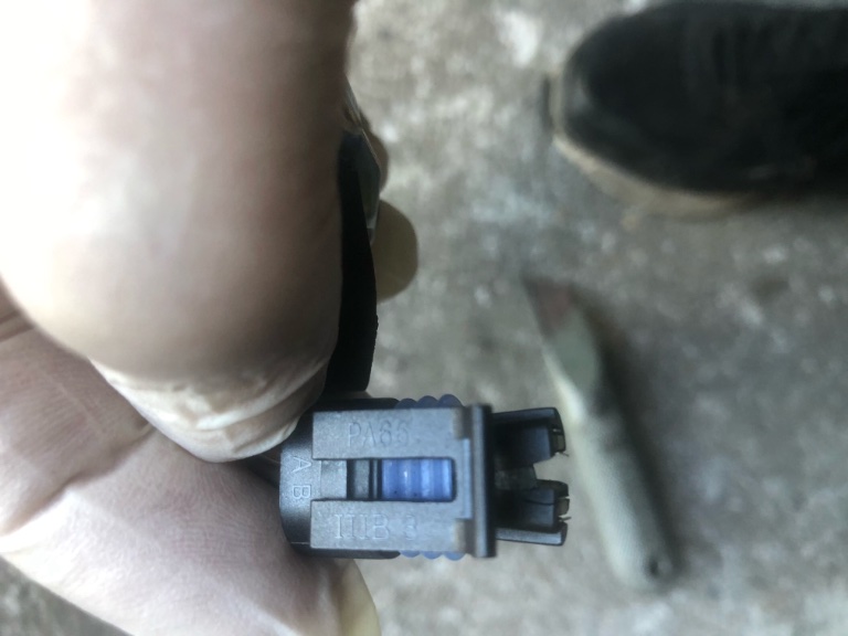

Connectors arrived today bit disappointed they are slightly smaller so I ran a Stanley between the 2 pins and slid a Packer in between and it fits I’ll put a dab of silicon around the water sealing seal when it goes on for good got some photos
