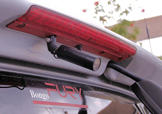

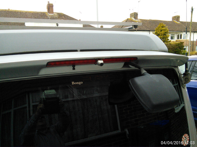

Much better view IMHO if mounted higher looking down, otherwise you lose depth perspective, I mount mine on the highlevel brake light.

Mine was routed through the high-level brake light and along the head lining I made a pod to hold a 7" screen by the rear view mirror
If I was doing another I would mount two cameras one facing the floor for parking and one facing backwards, the modern screens easily toggle between the two
