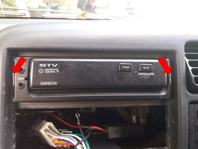

Can you not put a photo up without that we are just guessing at what you have ...

I cant see any holes to insert removal tools
Images are here
https://goo.gl/photos/gv8nVWggfmYBER287
https://goo.gl/photos/5kzaMPQqDSHhSc9v7
Many thanks

On the photo with the display closed, there appear to be two silver strips either side outside the case, are these not clips holding the unit in place ?

It seems that there is a tool which slides down above and below those strips.
Unfortunately I don't posses such a tool but have discovered that four steak knives do the same job!
Many thanks for your help.

Never used a proper tool myself yet! Skewers, knives, long nails all seem to work, otherwise leave the door open one evening with a notice saying Free SatNav ready for removal .....
