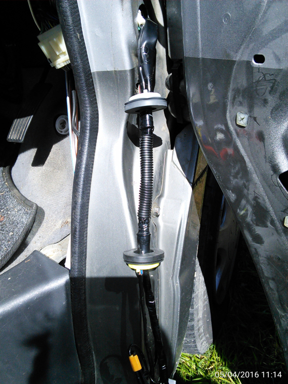

I've put together a pictorial guide for replacing the loom here, click the image below for the full works;

There is already a Factsheet that Helen put together, which has a VERY handy tip which I repeat in the pictures version - pull the connectors out of the A Pillar, I had spent ages trying to access the connectors from inside until seeing Helen's idea!

Where can you get the loom from? My central locking isn't working and I'm thinking this is likely a fix for it.

I had mine replaced only to discover later the problem was a dodgy connector in tbe control box behind tbe passenger glove box. Worth checking that before forking out (mine is temporarily sorted by not pushing tbe faulty connector fully home!)
