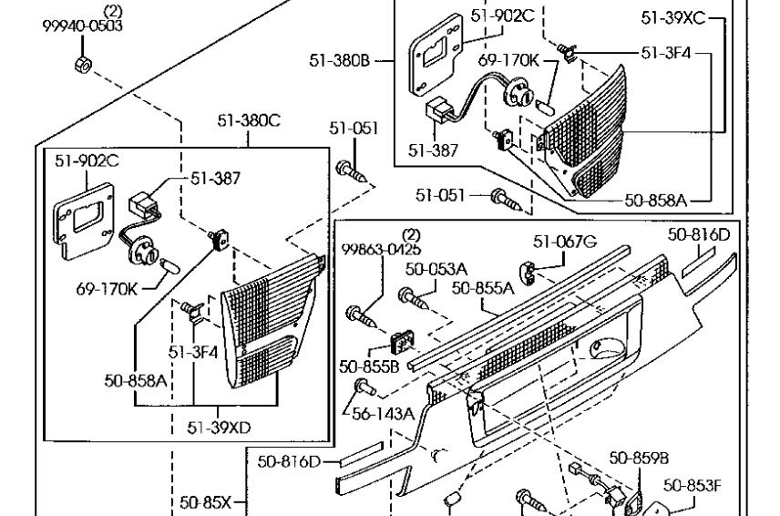

I have had to buy a secondhand tailgate lighting cluster to replace the damsged one on my van. During removal of the old one I had to disconnect the two outer lighting clusters wiring as there are bulbs in them. That came as a surprise as they had never illuminated. The van passes MOT tests as all of the essential lighting in the rear lighting (each corner) work ok. When I fitted the replacement reflective strip I ensured that I fitted new bulbs and when I carried out my lighting check they still didn't illuminate. So my question is when should these be lighting up? I thought that it could be possible that they are rear fog lights. But my van had to have a fog light fitted when inported to comply with uk requirments, which wouldn't have needed if these were fogs. Answers please ad it's been bugging me for a while now.

Which bits in the light cluster do you mean? Are they the tailgate ones? If so, only one bulb on each end should come on with the side lights.

it is the lights on ether end of the tailgate cluster as shown in the diagram, so from what you say they should be on when the side lights are on. But they're not, so I'm wondering if there is a brake in the wiring some where. I shall have to get my multimeter out and do some testing. Thanks for the help. By the way where did you find the exploded diagram that you posted?

Mechanical / Parts list diagrams;
http://lushprojects.com/bongopartsmk2/

Yep, the invaluable Lush Projects website (do we know who is behind that as we'd be really stuffed without it :)).
This is the page in question: http://lushprojects.com/bongopartsmk2/c ... 2of03.html
Do the number plate lights work ok? If they do, you could always wire the two sidelights to that wiring.
