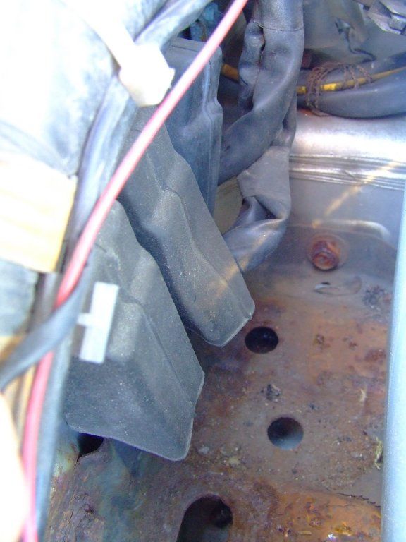

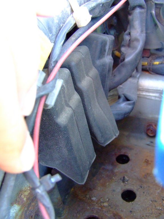

i will ask muz to photo them------ there is more than one on his driverside inner wing.--------very strange, maybe geoff could help. [-o< :wink:

Post by Muzorewa » Wed Jul 23, 2014 5:44 am
Will take photos this evening :wink:
Posts: 5269
Re: drivers side inner wing relays S reg diesel.
Post by Muzorewa » Wed Jul 23, 2014 5:52 pm
Well here they are, they're tucked away beside the starter battery. There are three, the one nearest the headlamp does all the clicking when the gears are worked.

And I have 3 same as muz
Carnt see the top of closest one but the rear one has H310 on top of rubber cover
