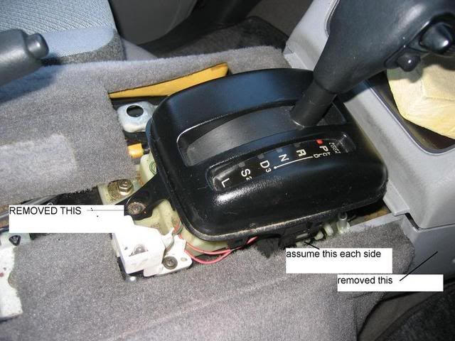

the ignition barrel and central door locking are not connected in any way,sounds like 2 seperate problems,the ignition release is a cable connected to the gear lever which may have stretched or broken ,the central locking could be a fuse or the solonoid in the door or the most favorite of all,the wires between the a post and the door have fractured to stop the central locking working!!!

as for the key part - remove the grey plastic bit and the smaller part of the guard from side. not sure how to remove the guard on the gear selector - can see the screw at back and then it just looks like two clips on either side - but not sure if i need this off. when i pop key in and turn to on - press brake i can select all the settings and i see parts moving inside. the key was ok to come in and out -
is this a fluke or should i suspect it is more a problem with the barrell ?
any thoughts appreciated
i attach this for reference of gearnob part
