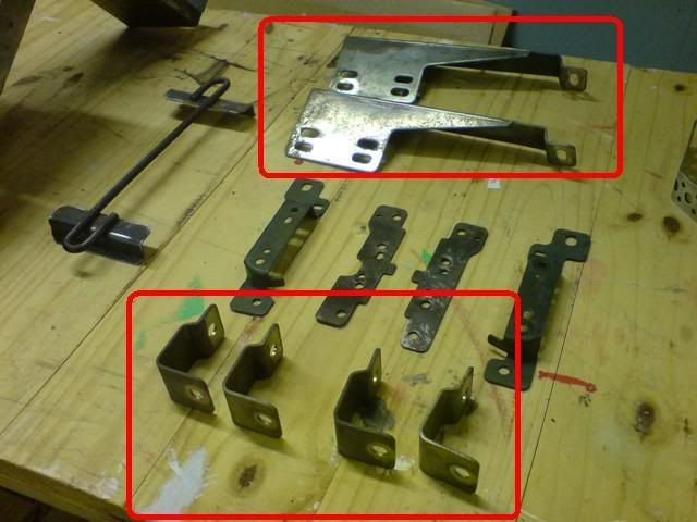

- Simon Jones
- Posts: 9341
Re: foglights
Ignore the red lines, but the original brackets can be seen in the middle:
The larger outer holes fit to the bumper while the smaller ones were for the screws that went into the rear of the lamp. You could just get a piece of black plastic, drill 4 holes to suit the bumper mounting points and then fit the lamp to the front.
