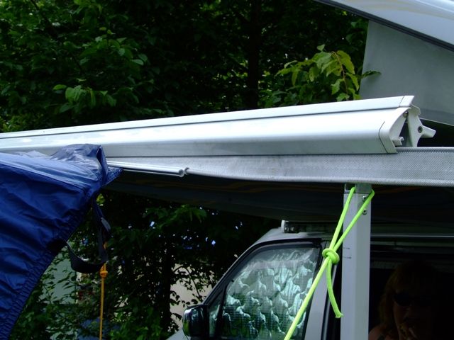

I think what seventiesboy means is when you open the casing, you should see a small channel like this (this is an Omnistor so not exactly the same as the YKK)....
Then you get a 3.0m length of the Kador strip (the grey thing in the pic below) that you can trim to length or just leave long, to connect the beading of your driveaway awning to the figure-8, and thence to the casing of your YKK :wink:

Ah i will have a look later and take a picture and upload on here. That's a great help seeing your pictures. Do you then wind in the YKK once its connected. This looks a very neat way of attaching the awning so i hope its possible with the YKK.

That's it :D :D :D
Well done Muz
Buy the kador the length that you need it, run it along the channel, attach the figure of 8, attach the bead on the awning tunnel to the figure of 8 and jobs a good un"
And, yes, wind it back in.

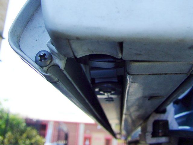

http://i1332.photobucket.com/albums/w61 ... c3.jpgHere is a picture of the ykk does it look like the kador and figure 8 will work?

Yep, that looks just the job :wink:
