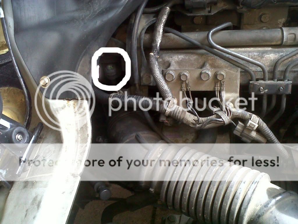

hubby is trying to fix an oil leak and has discoveredsomething that is broken, but we dont know what it is. the photos are taken of under where the middle console goes and are taken from the drivers side. have tried to circle the bits in the photos that are broken. looks like some kind of tubing has split and also has broken off from where it is meant to be.
hope someone can help and advise...
have circled the bit in this pic and you can see the tubing to the right of it that looks like it should be attached

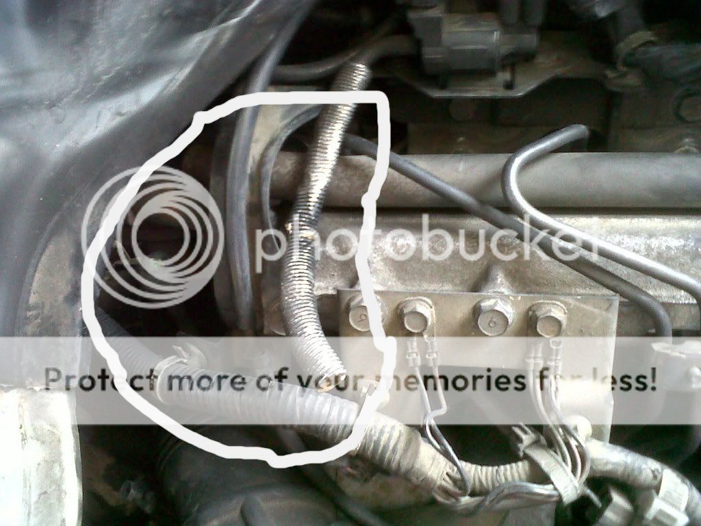

in this pic i have circled both bits together which i think re meant to be attached

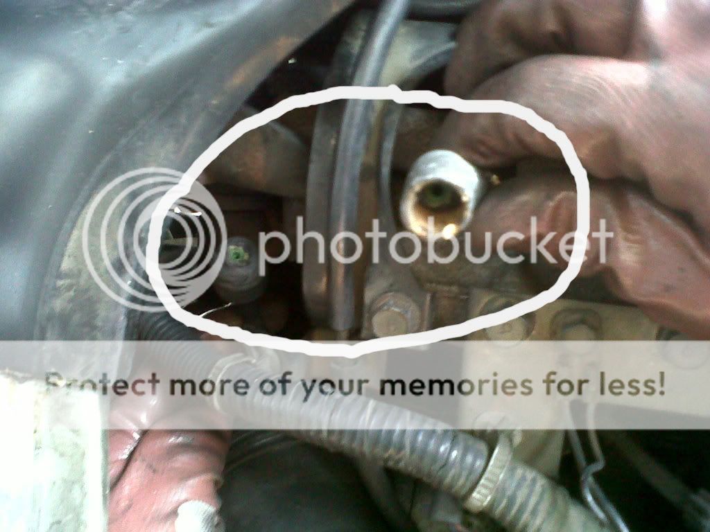

this pic again shows the tubing which also has a split in it as as well as the break

Hi its the check valve for the vacuum solenoids

any mazda with egr on them has the same part, scrap yard job.
its a one way valve.

its exhaust gas recirculation. its a way of cleaning up the emissions, this egr is not needed for the uk regs, and most dont work now as some bongo's are getting on a bit. if yours is still working you may need to repair/replace the part thats broken.
this is a one way valve that is linked into the air pipe circled.if this is broken it may suck air into the system bypassing the filter, and may whistle. the vacuum system may also leak and affect your cold start operation.

steve betty's is broke the otherside of the valve to yours (spenners), it looks like the valve itself has broke, a little more cunning may be needed to sort this. :wink:

yes :) get one off a breaker or any petrol mazda of the same age with egr on it.
