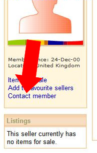

Ok guys so ive just been on e-bay looking for a willinton kit. It has no trace of them?? How do I get hold of one? How much are they? Oh and what do I get for my money??

Use the contact link to ask him to list the items / kit you want http://myworld.ebay.co.uk/willinton/

G8dhe, that just brings up the buyers name and says seller has nothing for sale!!! Tried putting it in ebay and thats all that came up, hence asking on here.

yes he quite often has nothing showing
However if you contact him via the contact dealer bit he will respond and will list what you need
How much depends on what you need just the split charge or battery tray or both
what you get for your money is a top quality all in one piece of kit that will charge your leisure battery and power your bits and bobs in the car as you need them with spare connections for non standard items or extras
