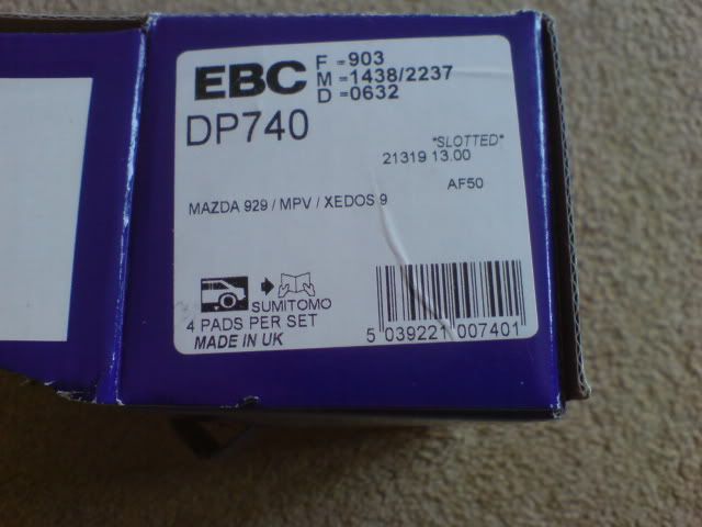

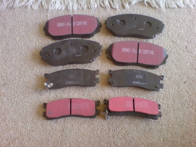

Not hugely impressed with the Eezibleed, worked once I siliconed in one of the supplied seal rings & an O-ring & left overnight to cure, but the valve connector fell apart, the tubing was too short on the bottle itself & the lengths they provide for bleeding the nipples are a joke. Worked ok once it was sealed, could do all four corners in a few minutes, but it was so much fannying about, I reckon the vacuum systems'd be better (if you've got access to a compressor), no fannying about trying to seal it then, just a quick suck on the bleed nipples.
Got the system emptied & refilled & the rear brakes stripped, cleaned up sprayed & reassembled (lots of bits of metal to transfer ) with the EBC Ultimax pads in, copper slip on studs & mating faces, quick "brake heavy" test run to bed in the brakes a bit.
Got the pads from http://www.ebcbrakesdirect.com, bit of hassle sorting out which ones to send as they panicked at the grey import bit, but we got there in the end, hopefully they'll be a bit more switched on to the bongo if anyone else orders,
Rears were part no. DP740, Fronts DP1121, £58.62 all in with delivery
Label for rears
Fronts
Fronts at the top, rears (smaller but more expensive) at the bottom
