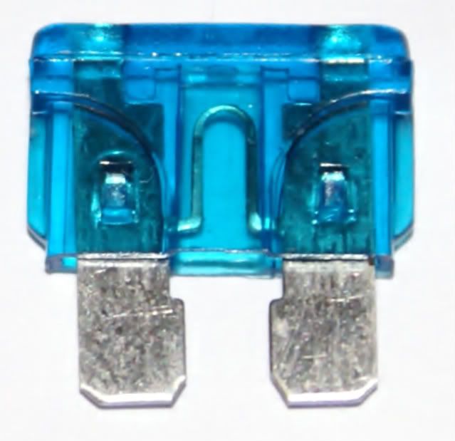

Take one of these fuses

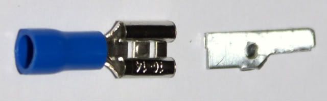

Cut it apart and cut to size with a pair of snips

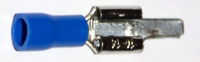

Make the grip from the crimp terminal tighter by squeezing it with a pair of pliers and force the little bit inside

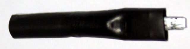

Cover it with a shrink tube and heat
Trim the ends and there you go
