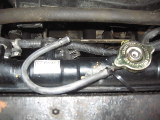

NOW FOR MY NIPPLE PROBLEM.
While I was doing this I took off the air ducting above the radiator , TO SEE COOLANT LEAKING FROM THIS NIPPLE ON THE RADIATOR CAP HOUSING.
There was no hose attatched and it is not blanked off.
Question is should this be blanked off (i'm thinking this could be a radiator off a ranger? so slightly different).
Or should there be a hose attatched and where is it?
