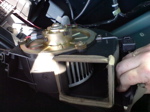

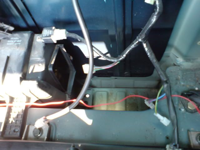

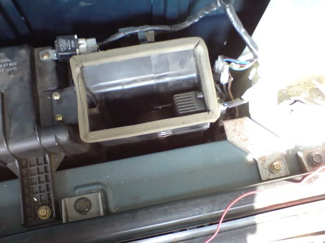

Luckily it's dead easy to remove the fan, one 10mm nut underneath just under the sill, remove the side panel ( if you haven't already like I had), two screws at the front of the fan housing & one 10mm bolt on the slightly rusty looking bracket, pull it up, 4 electrical connectors & its out.
Good spray of waxoyl in the crevices while it's out & the reverse procedure to put it back
