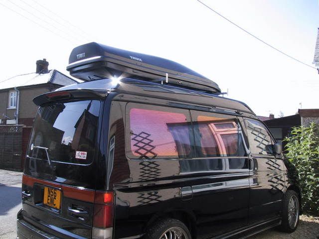

we've got a huge one on our freetop, have to help the motors lift the roof a bit, always make sure the box is empty of course, apart from the obvious don't go into restricted height carparks i don't think i would have tried without the roofbox on anyway :lol: it's the perfect storage solution for us, we camp with 3 kids, 2 adults and 2 medium sized dogs and get everything in there for a week's getaway :)

Indigo, tell us a bit more about how the box is attached to the bars. Are your bars sitting in the pre-drilled holes on the free top? How is the front of the box attached to the front bar?
Indigo
Post by Indigo » Mon Jan 22, 2007 2:35 pm
Ian wrote:Indigo, tell us a bit more about how the box is attached to the bars. Are your bars sitting in the pre-drilled holes on the free top? How is the front of the box attached to the front bar?
we had to re-drill the front holes, the rear ones were in the right place already. the bars are sitting in the pre-drilled holes on the free top.

Thanks. Is that a Thule 700 box?
Indigo
Post by Indigo » Mon Jan 22, 2007 2:40 pm
Ian wrote:Thanks. Is that a Thule 700 box?
it's a Thule Vision 850, we got it just before they discontinued it, it's the only one we found that size in black! :roll: it wasn't cheap either - £485!! :shock:

Post by vanvliet » Mon Jan 22, 2007 7:58 pm
That is one classy roofbox looks great with your black Bongo - best I have seen :) but the roofrack is ,well,grim :(

vanvliet wrote:but the roofrack is ,well,grim :(
In terms of colour? Or design? Or both?

Post by vanvliet » Mon Jan 22, 2007 10:20 pm
OK - IMO , and know that others might not give a damn - I think that it spoils the style of a cracking outfit. It looks like a ladder carrier from a commercial Ford Escort van I used to drive . Colour ? Yes, it could be improved by a black powdercoat. If it had been fabricated in round bar it would have looked a bit better. On the other hand it looks functional , making use of the Bongo roof mounting points . I am scouring scrapyards at the moment in an effort to fabricate / alter a pair of bars myself - the side rails and cross bars from an early VW Polo estate look like a possiblity - - They look a bit like this Fiamma system which itself might be a runner but for the price - - http://www.fiamma.it/prodotti/prodotti. ... 03&Fam=P02
