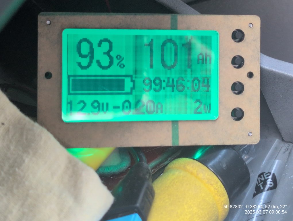

Yes the charger is intelligent and will drop down thru various states till its Float charge where it is just maintaining the current state of the battery. Mine just stays on full time no need to play with it at all, even when I'm at home and plugged into EHU the EHU charger works in a similar manner. If you really want to keep an eye on things then fit a Coulomb Meter like these https://www.ebay.co.uk/sch/i.html?_nkw=Coulomb+Meter that way your watching the complete state of the LB at all times I have mine stuck in the passenger glove box full time so always know what state the LB is in.

I like the look of the meter. Been using the Blue Tooth App of the MMPT but that looks better for tracking the actual charge state.

Indeed! You can get a BlueTooth linked version of the Coulombmeters as well saves running additional wiring into the van from the bonnet area.
