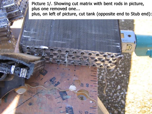

The problem with a simple flush of the entire system is that any deposits that get washed off the inside of the hoses has a habit of blocking the very small cores in the heating matrix. If you search thru the forum most people recommend disconnecting as many pipes as possible and then flushing and reverse flushing each component in turn. There is an excellent series of articles below on the coolant system;

Like the front heater matrix repair http://www.g8dhe.net/bongo_images/Paul_ ... placement/

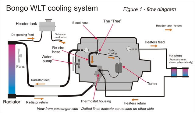

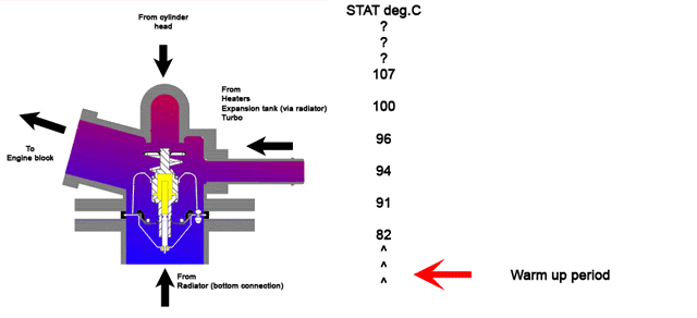

The bottom hose will be the coolest part of the system! The hot coolant comes out of the engine and then splits into several routes.
One is back to the engine (smallest pipe) via the thermostat top inlet (this gets sealed if the thermostat fully opens up).
Second is via the various heating matrices then back via the de-gassing tank (the highest part of the system in front of passenger), this then has a feed back to the thermostat control port to allow thermostat to sense the actual temperature of the coolant itself just before it enters the engine.
The final route is via the top of the radiator and down thru the radiator to allow cooling of the coolant, from the bottom of the radiator it feeds back to the thermostat from the bottom so that when the thermostat opens up the coolest coolant is allowed into the engine itself.
The diagram below is for the diesel engine, but the same basic setup is used for the petrol engines, but the locations are a little different;
The exact temperature at the bottom of the radiator will vary depending on air temperature, engine workload etc. but it will be the coolest. During winter it might not even get "warm" depending on just how hard the engine is working and how much heating of the aircon system is required! Click the image below to see the animation of how the the coolant is controlled by the thermostat
Bear in mind that the Bongo has a SEALED and PRESSURISED cooling system. There is no "top-up" tank which is used to maintain the correct level, as its sealed! Also its PRESSURISED by the expansion of the hot water, this is so that greater amounts of heat can taken away to the radiator more effectively, lots of European cars are not sealed and and pressurised. This means that any leaks in the system can be a PROBLEM as then the pressure drops, heat removal is affected, and it can lead to rapid over heating, the rest of the time it leads to better heat management of the engine than can be achieved with open unpressurised systems ....
