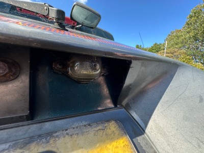

Working thru the list of MoT things on my bongo - one warning was the number plate light, if I can i'd like to change it, but for looking I cannot tell what type of screw/fixing it is !
https://photos.app.goo.gl/uWgAaF921eCKBfFV9
Does anyone know first hand, i dont want to butcher the screw if I can help it.
Al.ze

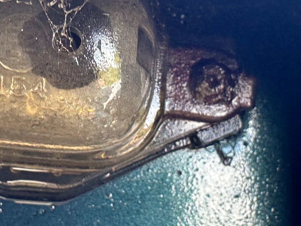

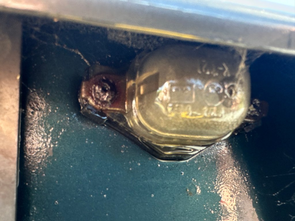

a couple more which are a little clearer !

Ah yes that style, lots of penetrating oil then try to get a well fitting screwdriver into the slot and hope it hasn't rusted too much I've used an impact screwdriver to get them moving but you need the style with a thin body or a robust extender arm to get the blade into that position.

Oohh, that looks like a potential pain.
In such cases I search for the best fitting screwdriver I can find, and applying as much ‘push down pressure’ as I can, I carefully try to get it moving.
Again, I also find a well place whack or two before hand, carefully applied obviously, can assist in loosening things.
On rare occasions I’ve had to resort to banging a suitable sized torx screwdriver or torx bit into it to get the required purchase and shift it.
Good luck 👍

The Bongo uses JIS screws (Japanese Industry Standard).
Almost like Phillips, but it’s worth getting the correct screwdriver, especially for rusted in ones.
