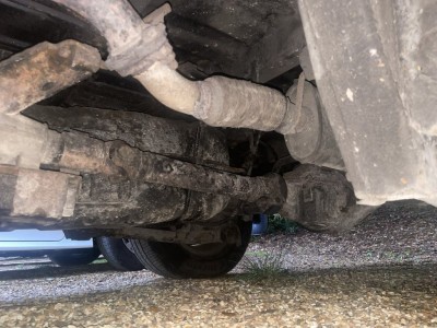

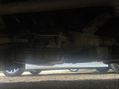

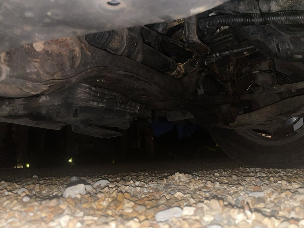

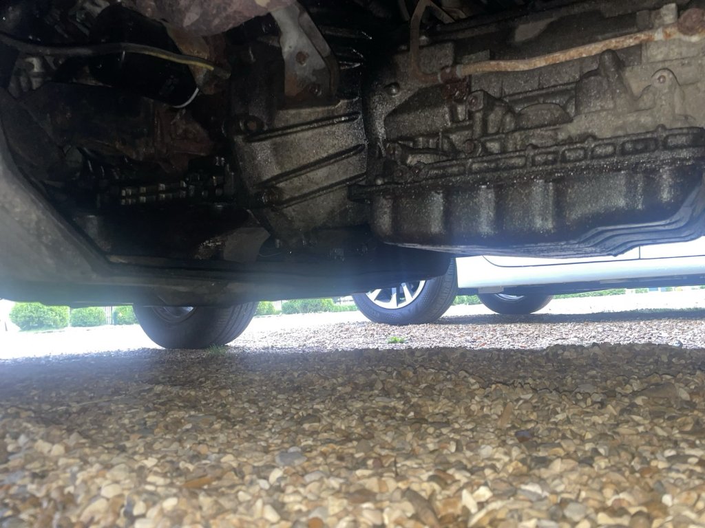

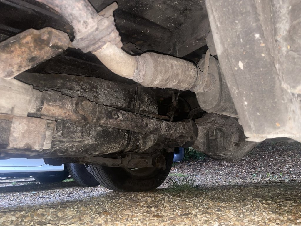

I am under orders to get a Mazda Bongo for the ex and kids. I would like them to have a 4x4 version. I am interested in a Bongo that is faaaaaar away. Before I went over, I asked the owner if it was a 4x4, they were not sure but took the time to send me these pics. Could someone please have a look and tell me if it is a 4x4, please? (I assume it is rear wheel drive and the Bellhousing is to the rear)

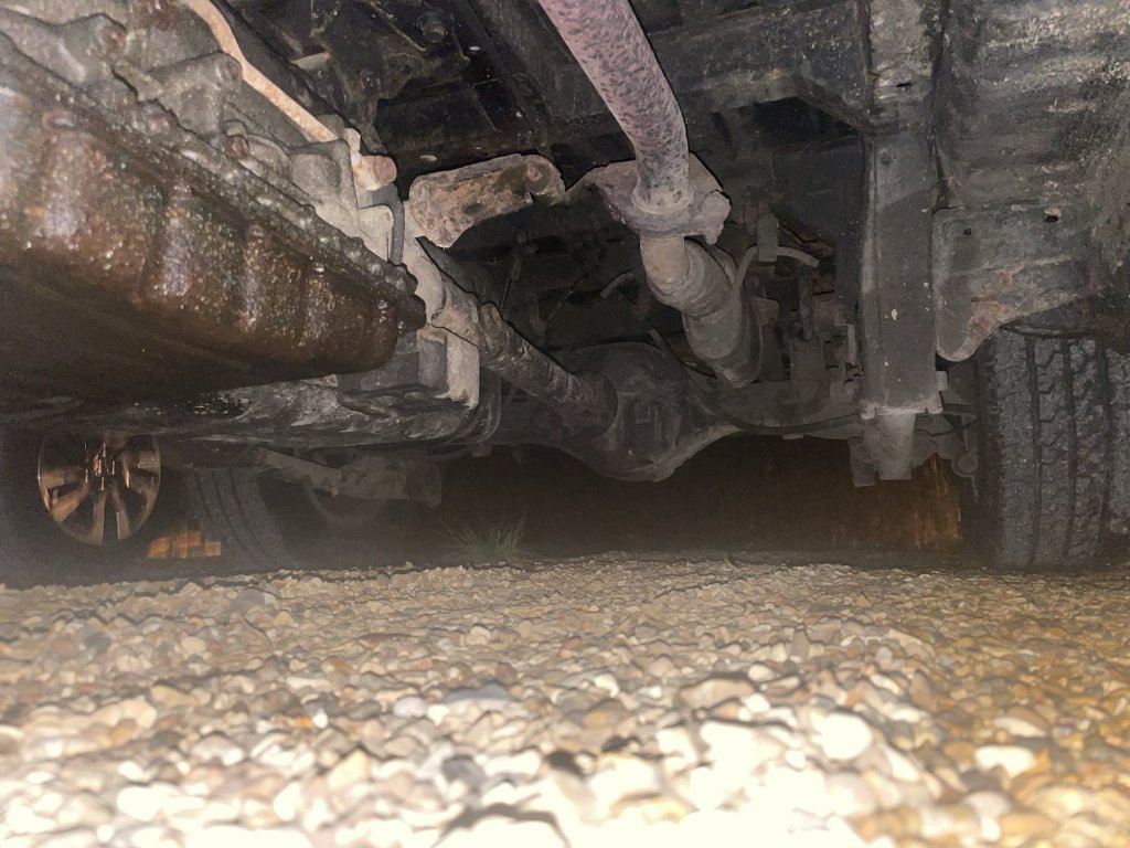

Post by udhi » Sat Jul 19, 2025 9:19 pm

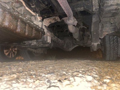

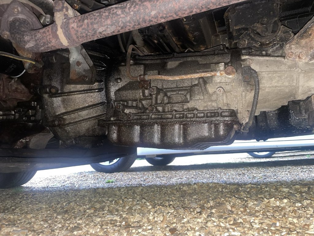

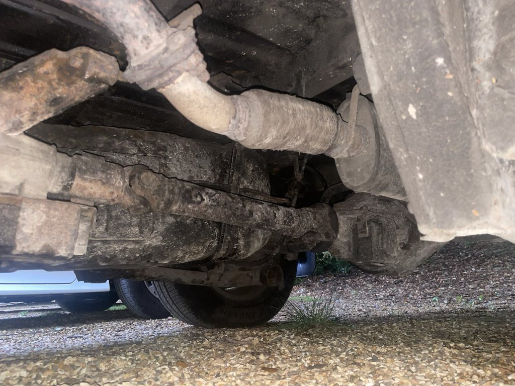

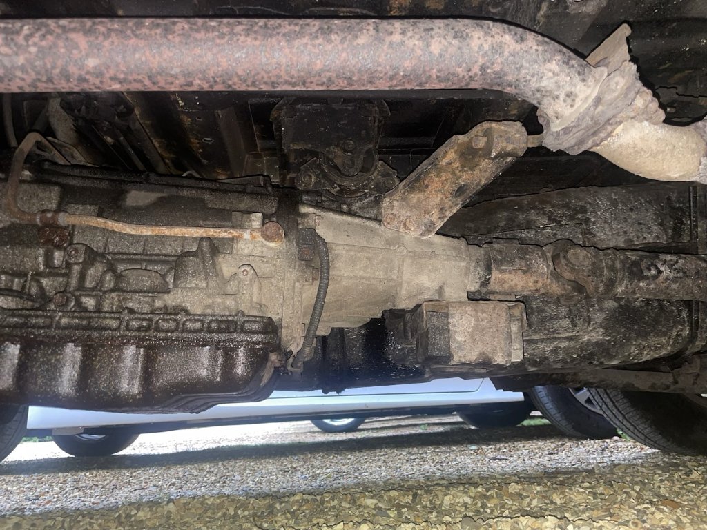

and two more:

You really want to travel and see a bongo where the owner does not know if 2 or 4-wheel drive and looks like that underneath??

I don't believe that is a 4x4 I can't see the transfer case that drives from the rear prop shaft to create the front prop shaft. See https://www.lushprojects.com/bongoparts ... 5tr.html#5 various pages on this list.
Why do you want a 4x4 ?
The 4x4 has a special clutch - viscous clutch - that causes the front wheels to be driven when the rear wheels start slipping, these are no longer available as spares. If it fails, and a lot have, then you have no option but to disconnect the entire front drive mechanism.
Unless your ex plans on doing a lot of mud work there is very little purpose on modern campsites in having a 4x4 other than costing more fuel to run them!

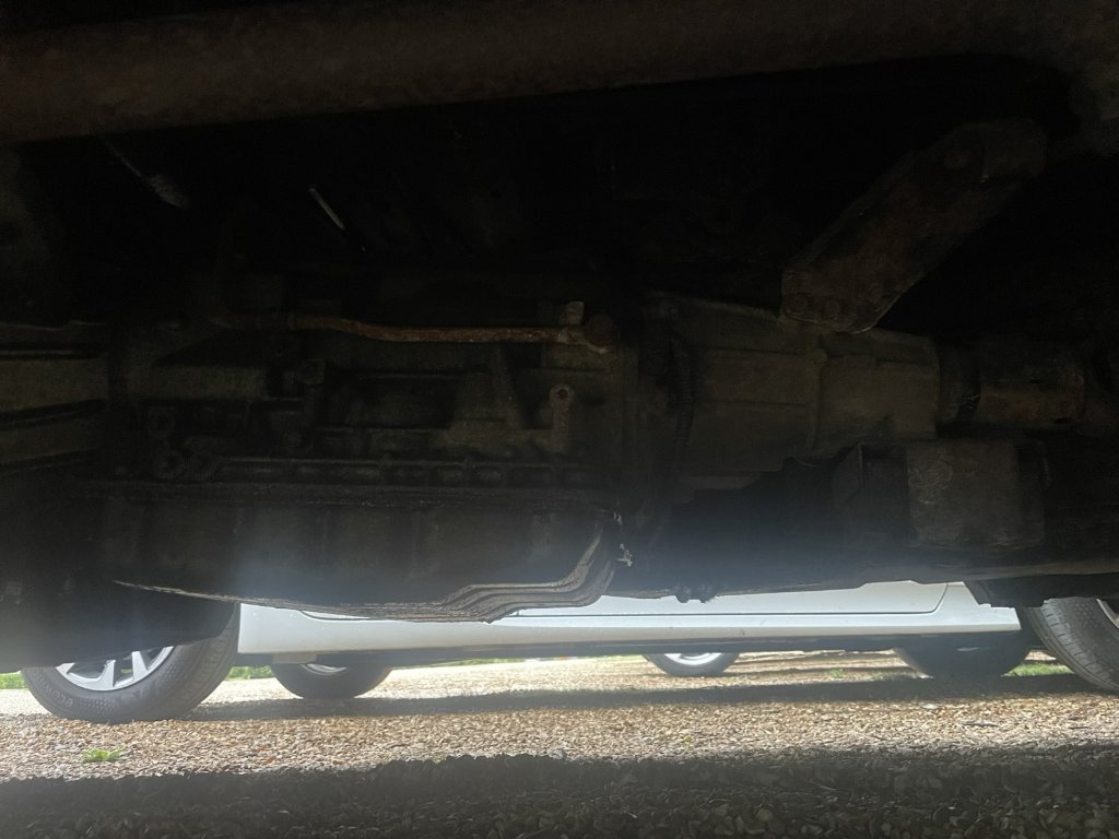

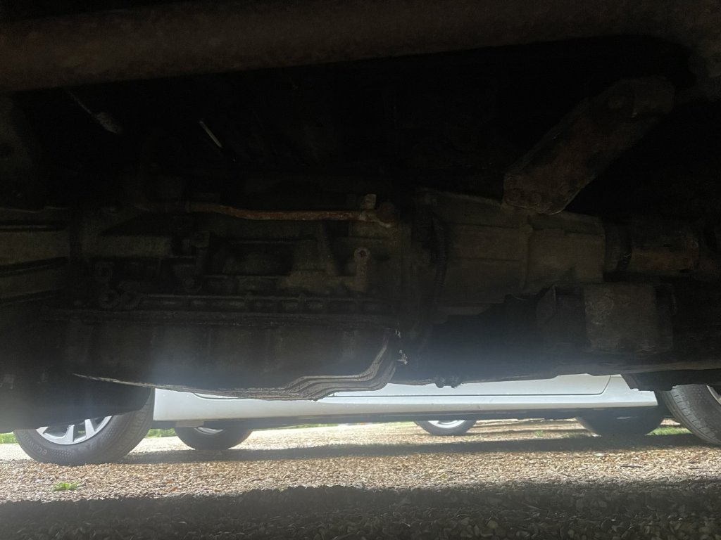

Thank You the owner has sent further pics (attached) that support your idea, that its a 4x2.
I had no idea that it was a Viscous drive with parts NLA! This really does put a tilt on my plans.

OK, that last photo clearly shows no transfer case or front prop shaft. the gap between exhaust pipe and gearbox is where the transfer case and front prop shaft sit.
Understand need for the 4x4 if your talking about off-road travel, however be aware that there is very little clearance on a Friendee between road and the engine undercover and hence the oil sump, especially on well pitted tracks! Its not really a vehicle well suited to rough terrain work, whilst the 4x4 gives you good pulling power and grip being so low slung your very likely to find yourself suspended on deep ruts. Something with a lot more ground clearance would be a much better choice!
Ah yes knew something was missing there isn't an engine undercover fitted on the photo's, this plays an important part in engine ventilation and cooling as it funnels the incoming air thru the engine compartment and out the back, with it missing the air tends to dive under the engine also noise levels are lot higher as the undercover also acts as a baffle for road noise.
