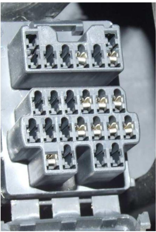

That's the problem. I have googled how to read the codes, but everything I read says to connect a jumper wire from the TEN to GND pin, then connect the LED from B+ to FEN. But inside my diagnostic port there isn't any pins where the TEN and FEN wires should be. So I can't connect anything to them.

This is a generic image that I found online, but my diagnostic port looks like this. TEN should be the second one in from the left, bottom row. FEN should be the fourth one in from the left, bottom row. But as you can see, those pins aren't there.
