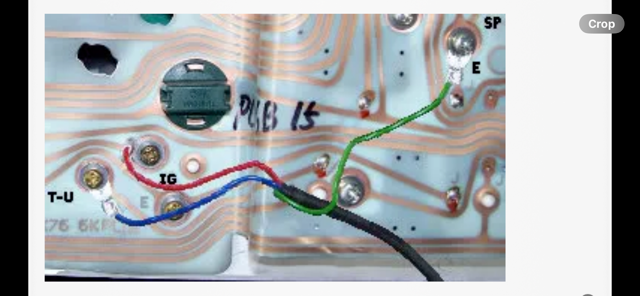

Anyway 9 years on and many miles it got hot and it boiled up a few weeks ago due to a stuck thermostat. I thought I had the fitting instructions for rewiring it back on the the instrument cluster but have been unable to find them. Can anyone help with a picture please?
I tried wiring it as per a picture I found but it does not work unless I remove the blue wire and reattach it then it works till I cycle the ignition.
