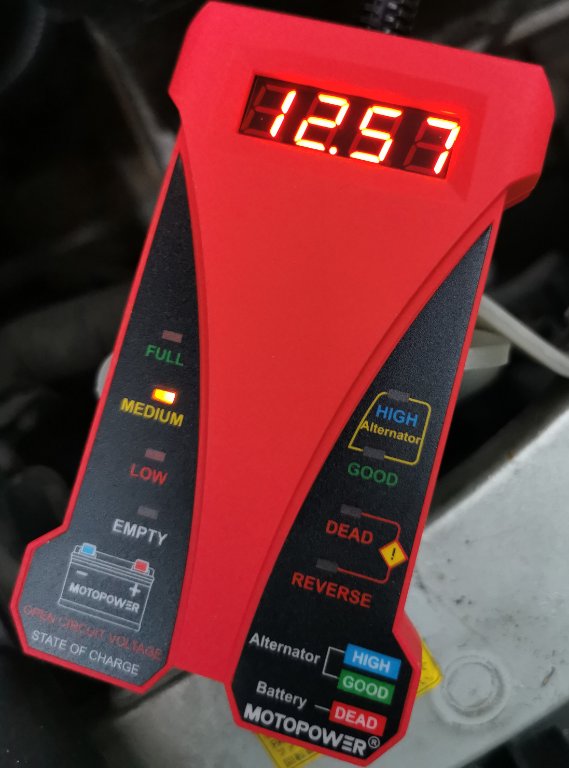

I bought a 12v usb adapter for the socket to connect to my leisure battery to use temporarily with the engine off. I connected my battery tester to the battery (12.70) and plugged in my son's tablet to see if it actually worked. It was charging but was dropping 00.01 roughly every 6 seconds or so. On this basis it would be dropping 01.00 every 10 minutes, meaning a small tablet would drain the battery quite quickly. Is this correct or have I got it completely wrong?! Essentially I want to know if I can charge things or use a 12v cool box with the engine off while camping with no EHU.

All Lead Acid leisure batteries will have a "resting" voltage (i.e. no current being drawn or charging current and allowed 30-60 minutes from last charging) of around 12.6 to 12.8 Volts, the precise voltage will depend on temperature and various additives used in battery manufacture.
The voltage alone does not really show the state of charge of a battery, merely that the normal battery chemistry is taking place, you will find that the voltage will rise quite a bit higher when the temperature is lower and lower when the temperature is higher!

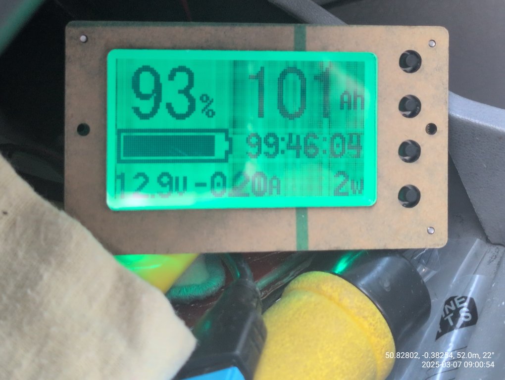

If you really want to know and understand the amount of charge in your battery then you need to fit a Coulomb Meter (Coulombs are the measure of charge unlike Voltage and Current which depend on the load running from a battery) these are quite cheap these days something like this one https://www.ebay.co.uk/itm/396209169673
My own just sits quietly in the glove box and gives a continuous display of the Capacity left in the battery, Voltage, Current, and time to fully charged;

My own just sits quietly in the glove box and gives a continuous display of the Capacity left in the battery, Voltage, Current, and time to fully charged;IMG_20250307_090054.jpg

So essentially, the voltage dropping doesn't necessarily mean the battery is getting low?

Nope that looks absolutely fine as far as a voltage reading goes, but as I say it doesn't actually indicate a lot of information about the state of the battery itself.
