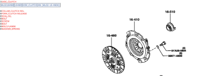

According to the part numbers from the worskhop diagrams for the clutch I am seeing:
the part number for the
release bearing G56116510
clutch plate WL0216460
clutch plate cover: WL0116410 / WL0216410

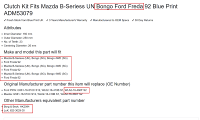

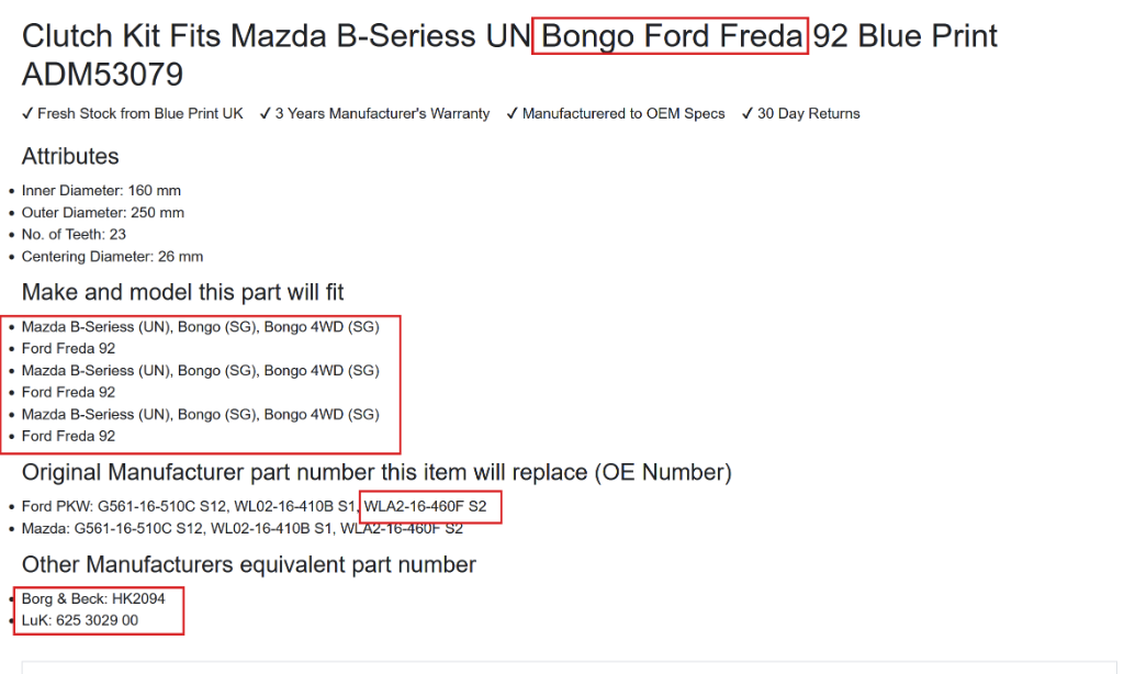

I have seen a kit which details:
but the part number for the clutch plate is WLA2-16-460F S2 and not WL0216460
A long shot, but has anyone had to change a clutch on their rare manual bongo or know the significance of the WL02 and WLA2 part numbers please?

So I managed to speak to Holly at Mazdabongo.com is so super super helpful and
ADL blueprint number for the kit is ADM53073 .
Cross references to Borg + Beck HK2094
With my VIN and liaising with Mazda themselves they were able to find the correct kit
I will see what happens when the gearbox is taken apart next week :roll:
