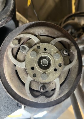

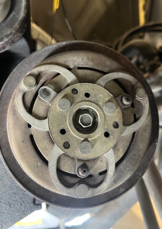

I believe that the clutch on my air conditioning compressor is seized but as I have no experience of these things, I’m not sure if it’s doing what it’s meant to or not! It had no belt on it when I bought it. When I turn the wheel that the belt would normally go around, it spins quite freely. But the fancy bit on the front will not turn by hand. Should it? See attached. It’s a 2004 2l petrol by the way.

The clutch is an electromagnetic one, the coil when energised at 12v creates a magnetic field that causes the two plates to pull together and engages the pully shaft with the pump shaft. Refer to the diagrams on-line 61-L11 & 61-L12 are the clutch plates and 61-L13 is the electromagnet;

I see. Thanks for that. So the wheel should turn freely until the clutch is activated and connects the wheel to the shaft and drives the compressor? So if I touch 12+ onto the wire going to L13, I should see/hear the electro magnet activating? Assuming it’s not broken.

That's right. The usual problem is that the pump has at some point failed and when the clutch engages the pulley starts slipping and causing problems and noises! Hence a lot of people remove the belt so that the other controls can be used but the cooling isn't engaged.
