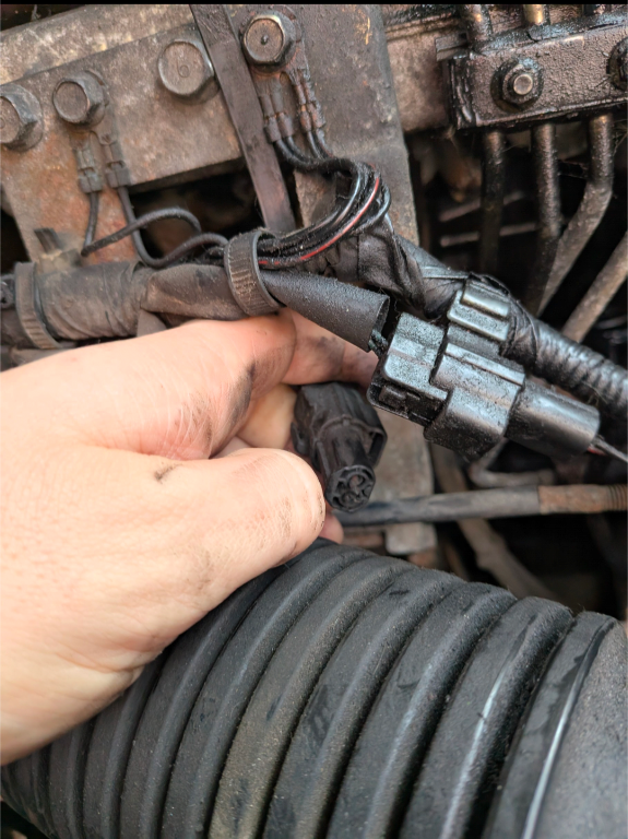

Also while looking around I noticed this cable hanging about, probably not related but looks like it's connected to a sensor, possibly the ECT sensor? Where would this plug into? Can't see anywhere at all it could go
Have attached a picture below
