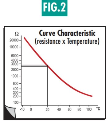

The actual circuit is;
The additional resistor is added across the temperature sensor itself apparently according to the original write-up.
If its going full scale then it sounds like the sensor is being short circuited somewhere?

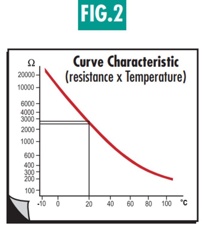

The sensor is a 3119 device https://www.mte-thomson.com.br/wp-conte ... a-2018.pdf some details in this catalogue including NTC parameters.

Thanks Geoff. Unfortunately the datasheet does not tell you the expected resistance at any given temp. Not in the manuals either. No idea at the moment whether the sender, cluster, gauge or wiring are at fault. Will let it get frozen tonight and see if it manages to drain a CR network somewhere and kick it back into life. Really annoying when something was 80% good is not 100% useless :(
Don't really want to have to drain the coolant to try a new sender "just in case" but suspect that may be next move.
Posts: 10971
Re: V6 petrol additional temperature gauge issues
Post by g8dhe » Sat Mar 01, 2025 6:49 pm
Er Page 34 ?

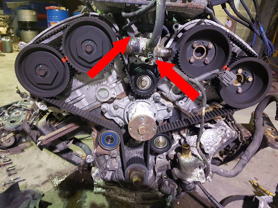

Cheers. Will let it get really cold tonight and see what it does in the morning. It all seems like passive components so can't see that anything needs to learn parameters etc but maybe (hopefully) the sender hasn't really had to work for the last 3 months and got upset when it got properly hot for the first time. Will see what the morning brings. Any idea if you can change the sender without draining the coolant? It the system watertight enough to not flow out? If not, guess it gives me a chance to practice the bleeding system once again. If I drain it through the sender hole then shouldn't be too much drama.

The sensor is high up but can be difficult to reach;
One is the two-wire feeding the ECU and the gauge is the single Green wire.
