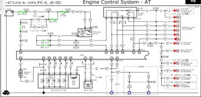

You need to refer to the electrical diagrams which require use of Flash at http://www.g8dhe.net/bwm/ see the discussion on the wiring diagrams on this forum for details of browsers that still support Flash ( https://igmaynard.co.uk/bongo/forum/vie ... 68#p723668 ). There is also the gearbox manual available http://www.g8dhe.net/bongo_images/Gearbox/RC4AEL.pdf
A small image of the relevant page below;

Hi.
Is that gearbox PDF manual for my vehicle? That looks like a later model 'box...
The PDF manual refers to shift solenoids A/B/C/F but the wiring diagram snip you kindly posted only has shift solenoids A/B.
I'm very confused..

The diagram shows a total of 5 solenoids A/B/D/F & TCC, never needed to assign each of the there functions see page 05-13Y-3 where it refers to ABDF&TCC and then the table on the next page where it refers to A/B/C/F&TCC

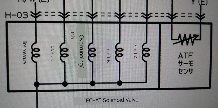

g8dhe wrote: Fri Feb 07, 2025 11:52 pm The diagram shows a total of 5 solenoids A/B/D/F & TCC, never needed to assign each of the there functions see page 05-13Y-3 where it refers to ABDF&TCC and then the table on the next page where it refers to A/B/C/F&TCC
In the diagram I can only find a lot of Japanese-labelled solenoids, only two of which translate to shift solenoids (A and B). The other solenoids (Overrun/Lock-up/Line Pressure) are not referenced in the PDF (RC4AEL.pdf)
Ha Translated.
Ha Translated.
Is RC4AEL.pdf for my vehicle? It seems to be a newer gearbox than my camper... or does it work the same way?

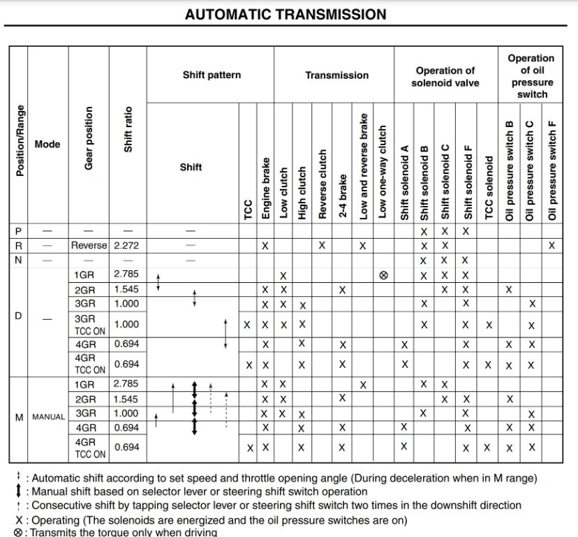

Which gearbox do you have on your vehicle ?
See the table on 5-13Y-4 which shows which solenoids are operated for each gear selection, its not a simple one wire one gear mechanism, its a binary selection from the control solenoids and the internal pressure switches;

The translations and naming's seem to vary a lot depends I suspect on the sources of information if you look up in the gearbox manual you will see that a lot of the selections is on the basis of the two main gear choices and then the various epicyclic combinations give the other gear ratios.
The display temperature gauge has no other input to any of the vehicle systems its only for the display alone if you look at the diagrams. There is another temperature sensor (2-pin types) that measures the temperature feeding the ECU. The gearbox has its own sensors internally feeding into the gearbox electronic controls.
