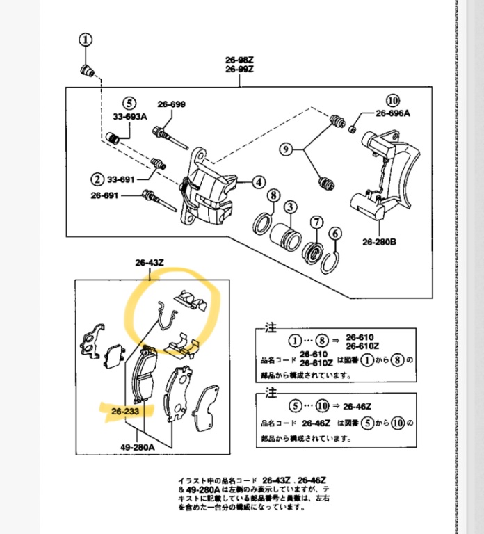

Hey folks, looking to source a brake ‘spring’ currently missing from the rear calliper on my 98 Bongo.
1. Does anyone know where I can find one
2. If any brake pads come with the spring
3. Is the part common to any other Mazda (I guess many may use the same calliper)
4. Anyone made one from other suitable easily sourced donor parts
Any/all info appreciated 👍
It’s part #26 in the pic

The rear pads on a Bongo are the same as a Mazda MPV. The Mazda part number of the spring is H26626233 and your local Mazda dealer parts dept. should be able to obtain one.
