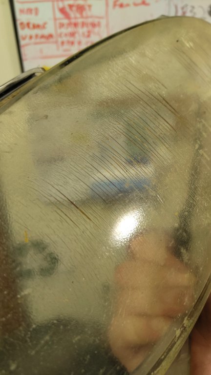

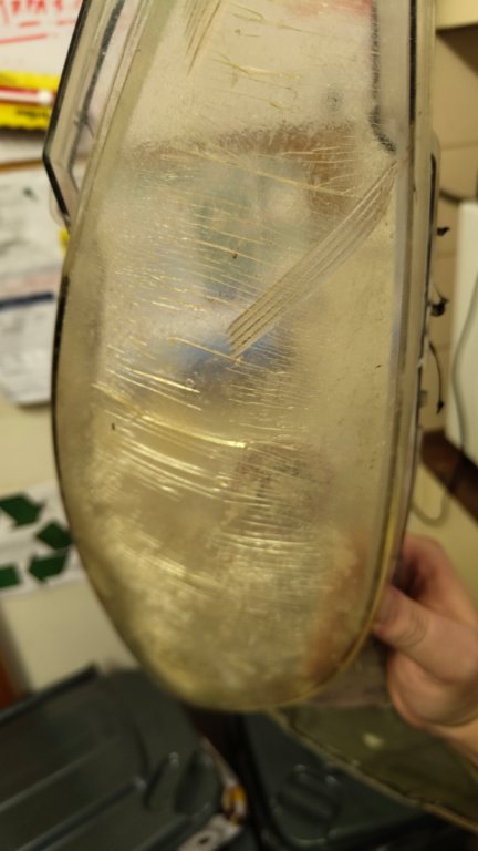

Mainly looking to replace rather than polish. I used many different brands of polish on the 2010 Mazda6 over the years... They'd always yellow up again in about 6 months every time. In the end, they looked like this:
After replacing just the lenses with new ones:
So, looking to just replace the whole headlight assembly if we can, or even bake out and replace the lenses. But I need to know are the KH-SGL5 headlights the same as other models, such as the GH-SGEW?
