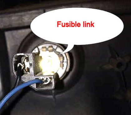

The 12v socket is fed from the Ancillaries fuse, which if you have a leisure battery means its been transferred across to it from the starter battery normally by removing the standard fuse (top right, 10Amp or 15Amp in fuse box by drivers knee) and replacing it with a wire in a small loom to the fuse panel for the leisure battery (normally close to the LB) it could be this fuse blown but in that case the Radio and other devices fed from it won't be working! Or the fuse on the socket itself has been blown (more likely if other things are working) often by a tyre pump drawing too much power! In which case you need to release the socket extract it and (personally I bridge the blown fuse as its not the sockets job to protect the devices cable) repair it which is difficult as its part of the socket itself! See the images below;
Use this link to see how the socket is released to get at the pins and fuse http://www.g8dhe.net/bongo_images/front ... et_images/
