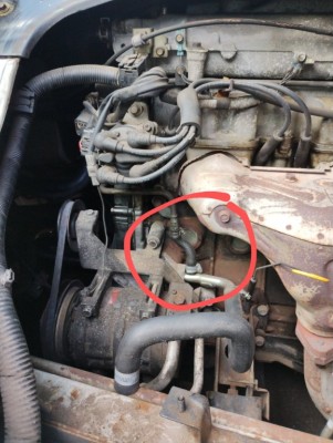

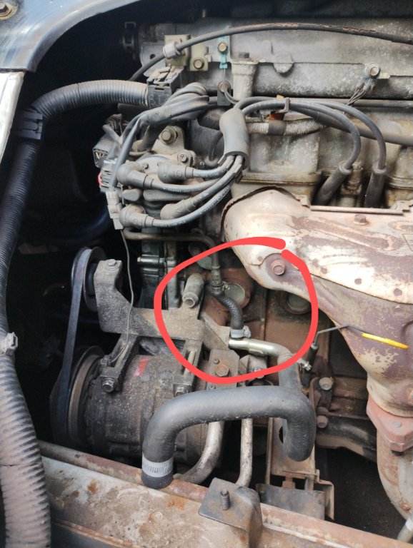

Hi all, I've recently had the main coolant hose replaced on my 2L Bongo, the others all seem to be OK, but this little guy in the picture is looking a bit ropey to me and I wouldn't mind getting it changed for piece of mind when I have my cam belt and water pump done early next year. I'm struggling to identify it. Under the passenger seat, just to the left of the dip stick, picture attached. Thanks in advance!

Hi yes i had to have that pipe changed on my bongo its like a tee shape 3 way pipe and the end with the jubilee clip corrode ,but i could not find it in the UK so the garage that used to do my servicing and repairs had to order it from Japan which took 8 weeks . i did have part number but was passed on with van details when sold sorry .

Thanks for the reply. I've had the metal pipe changed last year (it also came from Japan and took many weeks!), it's the small rubber hose that comes out of the top of it that I'm after.

There is a set of diagrams with diagram part numbers here on the shop site https://bongoland.co.uk/identifying-your-hose/
but if you use the full parts diagram https://www.lushprojects.com/bongopartsmk2/ it also has the full Mazda code number in the table top left on each page, rather than just the shorter diagram number, then you can simply Google the full part number for suppliers.
A quick look suggests diagram number 15106B which is F8A615537A and a Google https://www.google.co.uk/search?q=F8A615537A

Thank you! That's really helpful, I agree with the part number. Replacement ordered, hopefully catastrophe avoided! Thanks again.
