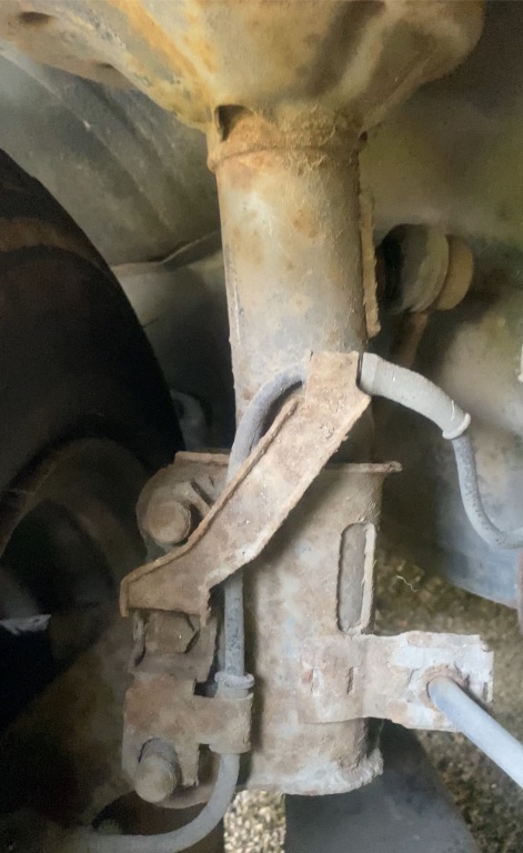

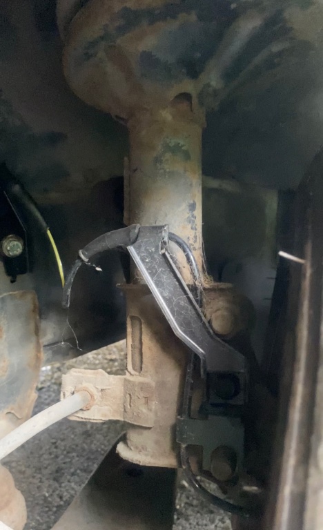

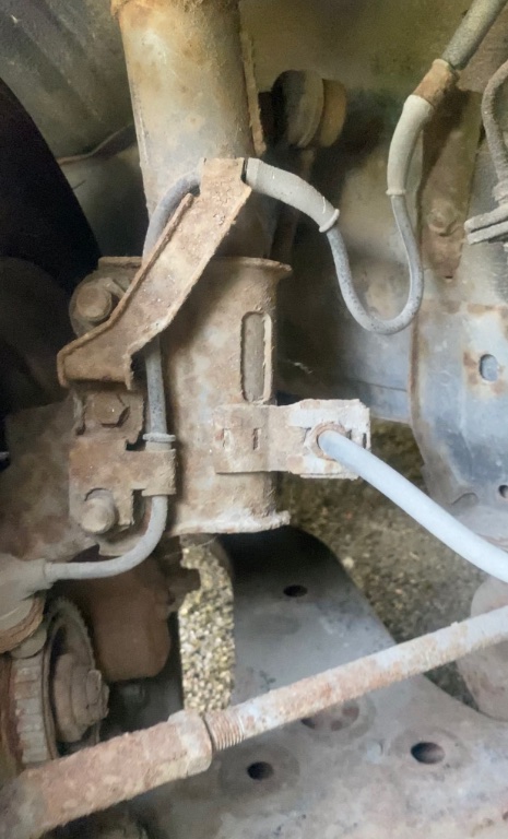

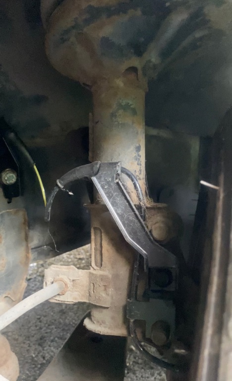

Hi all,
I’m very new to the forum and have owned a bongo for just a few weeks! We are super excited to be part of this community but we’re faced with a bit of an early owner predicament.
Symptoms are the car had a light impact resulting in a dent in front wing. As a result, driver side front wheel is leaning inwards from the top, from driving just a short distance, there was a whining noise as if the tyre or wheel grinding against something.
I had a look underneath and it appears the shock absorber is bent (see pics), but I can’t be 100% certain. Any suggestions such as weak points in the suspension or where I should be looking? The insurance won’t cover it as it’s 3rd party.
Many thanks
Dee
Passengers side for comparison
Driver side
Driver side
Driver side
Driver side

Looks like the wheel took more of the brunt of the collision than the dented wing is telling you, inside that shock is a steel rod which is the damping mechanism, if its bent as it looks to be the shock isn't doing its work, I just had one fail and spew its oil out which was giving the same symtoms of bounciness though my other components weren't damaged or out of alignment.
I changed both shocks together which was a bit of a pita but its driving like brand new again, I suggest you have that shock replaced and have the alignment done though it may not need it once theres a straight shock in there which will/should pull the wheel into its correct position.
