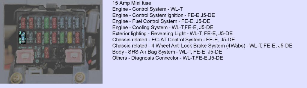

Have you checked the fuse supply to the Power Control Module of the ECU ?
Its the highlighted one middle row left, this feeds all the solenoids which are operated by the ECU around the diesel engine, including the fuel cut-off valve which is simply earthed via the chassis so as soon as the Ignition is turned On then the cut-off valve opens its the Black/White wire in the engine bay.
