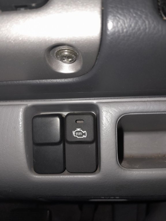

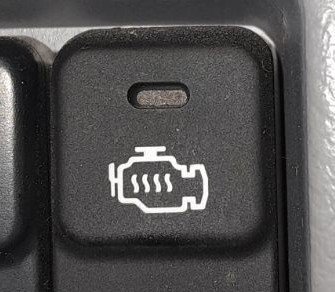

What is this button/Switch? It's located to the down and right of the steering wheel.
The Mystery Button
The Mystery Button
The Mystery Button and surrounding area.

by g8dhe
Its the engine fast heating button, used in Northern Japan, it forces the exhaust gasses back around the engine to get it hot quicker by closing a valve in the exhaust. In the UK they are immediately stripped out as they are fully exposed under the vehicle and handle the hot exhaust gases hence they rust badly and invariably seize up in the re-circulate position - NOT A GOOD OPTION!!!!
Try a search on "exhaust recirculate valve" for more info or "Northern Japan" plenty of info about removing them and sealing the vacuum pipe!

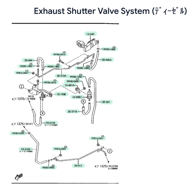

Just to confirm that i am 100% looking at the correct thing, that would be what Yoshi Parts are referring to as the "Exhaust Shutter Valve System"?
Re: The Mystery Switch?
Posted: Wed May 29, 2024 9:43 am
by g8dhe
Yes 13-540 is the valve itself the rest is the connection and control from the vacuum system which operates it. You need to seal the vacuum tube when its removed otherwise your other vacuum operated controls will be affected!
