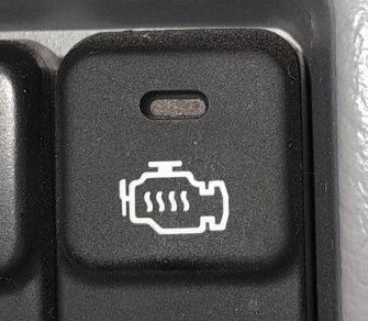

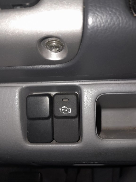

My brother owns a 2001 Bongo Friendee Camper, and he's been looking everywhere for the answer to this question.
(His bongo did not come with the owners manual, and Google has been even more useless than normal. I even tried asking an AI, but it got it wildly wrong by claiming its a warning light for coolant too hot)
What is this button/Switch? It's located to the down and right of the steering wheel.
The Mystery Button
The Mystery Button
The Mystery Button and surrounding area.
Posts: 10958
Re: The Mystery Switch?
Post by g8dhe » Mon May 27, 2024 10:03 am
Its the engine fast heating button, used in Northern Japan, it forces the exhaust gasses back around the engine to get it hot quicker by closing a valve in the exhaust. In the UK they are immediately stripped out as they are fully exposed under the vehicle and handle the hot exhaust gases hence they rust badly and invariably seize up in the re-circulate position - NOT A GOOD OPTION!!!!
Try a search on "exhaust recirculate valve" for more info or "Northern Japan" plenty of info about removing them and sealing the vacuum pipe!

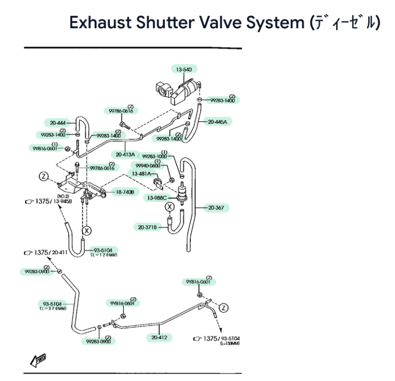

g8dhe wrote: Mon May 27, 2024 10:03 am Its the engine fast heating button, used in Northern Japan, it forces the exhaust gasses back around the engine to get it hot quicker by closing a valve in the exhaust. In the UK they are immediately stripped out as they are fully exposed under the vehicle and handle the hot exhaust gases hence they rust badly and invariably seize up in the re-circulate position - NOT A GOOD OPTION!!!!
Just to confirm that i am 100% looking at the correct thing, that would be what Yoshi Parts are referring to as the "Exhaust Shutter Valve System"?
Posts: 10958
Post by g8dhe » Wed May 29, 2024 9:43 am
Yes 13-540 is the valve itself the rest is the connection and control from the vacuum system which operates it. You need to seal the vacuum tube when its removed otherwise your other vacuum operated controls will be affected!
