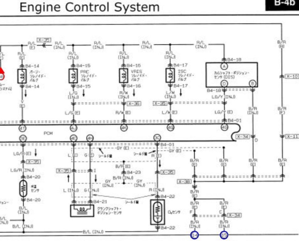

From searching the forum, it seems the cam sensor is in the distributor, would this be prone to failing when hot and preventing a spark to the plugs? Is there anyway I can test this?

Thanks for the link, is there a way I could test the signal from the sensor when its cold and then hot?

There isn't a lot of info on the sensor, my guess is it would be a solenoid or a semiconductor for detecting a magnet on the rotor, but there are other methods possible but the diagrams just treat it as a module top right below, it appears to have +12v (A), Earth (B) and the output lead going to the ECU (O). YOu would expect that a scope on the (O) lead might be a pulse
