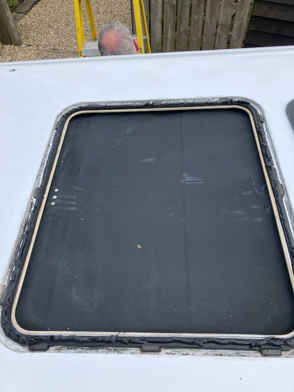

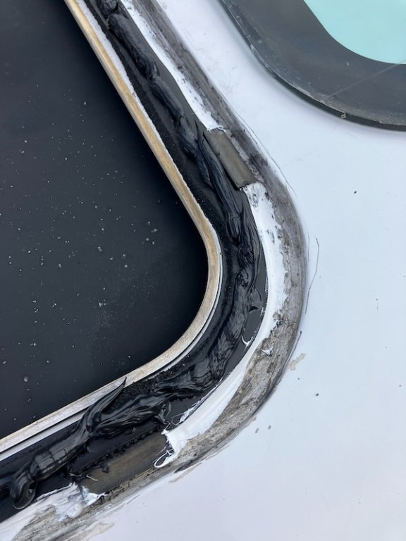

Have been struggling with leaking AFT skylight for last 2 years. Tried to silicone all around as a temporary solution. Held for 10 months but then leaked again. So, after some extensive research and several garages saying no to the job, I tacked this myself. First I removed all the silicon I used previously to stop the leak, then removed the glass, cleaned it all, and glued it back on using CT1 unique sealant and construction adhesive (black). also used Silkaflex 522 (white) on the outer edge in order to make it more water tight. In the end put 20kg bag of top of the glass and let it settle/dry for 12h. Result: the glass did not fly off when on M4 but the bad news is that the skylight is still leaking. Any tips? I am a bit disappointed as I was sure we did a good job and also cos I cannot use the van. Here is the link to the pics of what I did. Thank you! https://drive.google.com/drive/folders/ ... drive_link

Thank you! I wish it was condensation. Defo leak and quite some water. Have been using low food containers for a while now when stationary to collect/dispose of the water. After the repairs, I was so confident we did a good job that I did not use the containers and after the rain, I went to check on the van, and there was water everywhere: on AFT, floor, seats, roof, sides ...

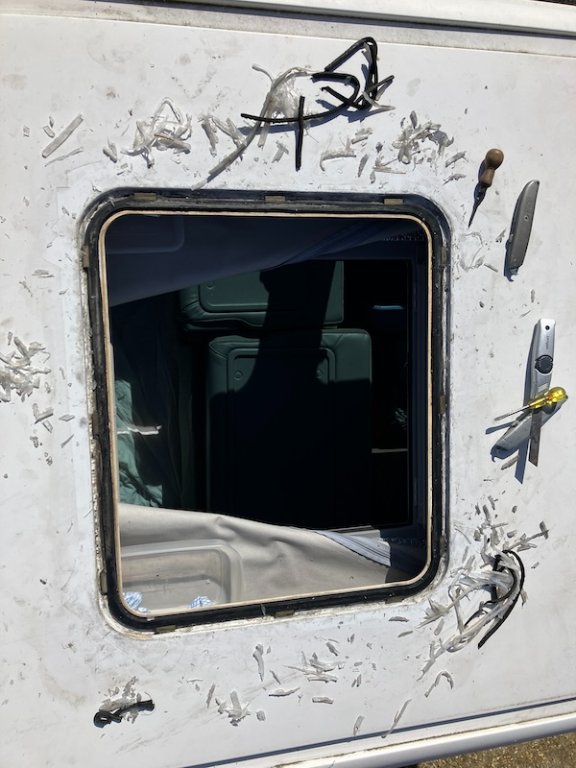

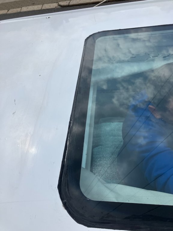

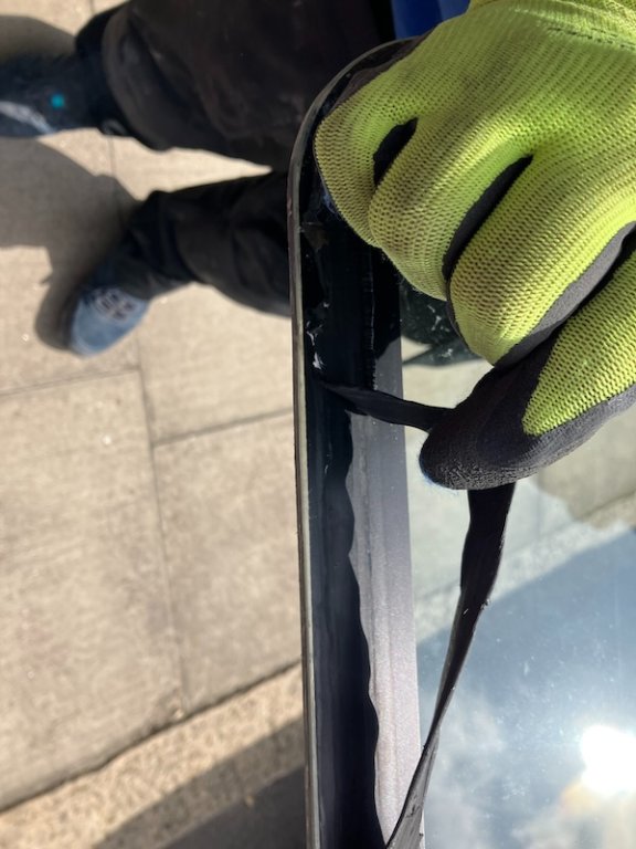

Thank you! Yes, I did follow the instructions on removal/repair from the manual. Yesterday as the storm was approaching, I decided that I need a glass fitter's help. He removed all and said my repairs failed as the black silicon did not bond to the glass (see pic). Asked me if I used alcohol based cleaner and I did, so not sure what went wrong. Anyway, he took it all off, re-did it and it just looks amazing, not like what I did (he filled the ridge with the black silicon too). And the best bit, no leak after the last night storm. I might be finally able to go camping without having to have a bucket at hand. :D
