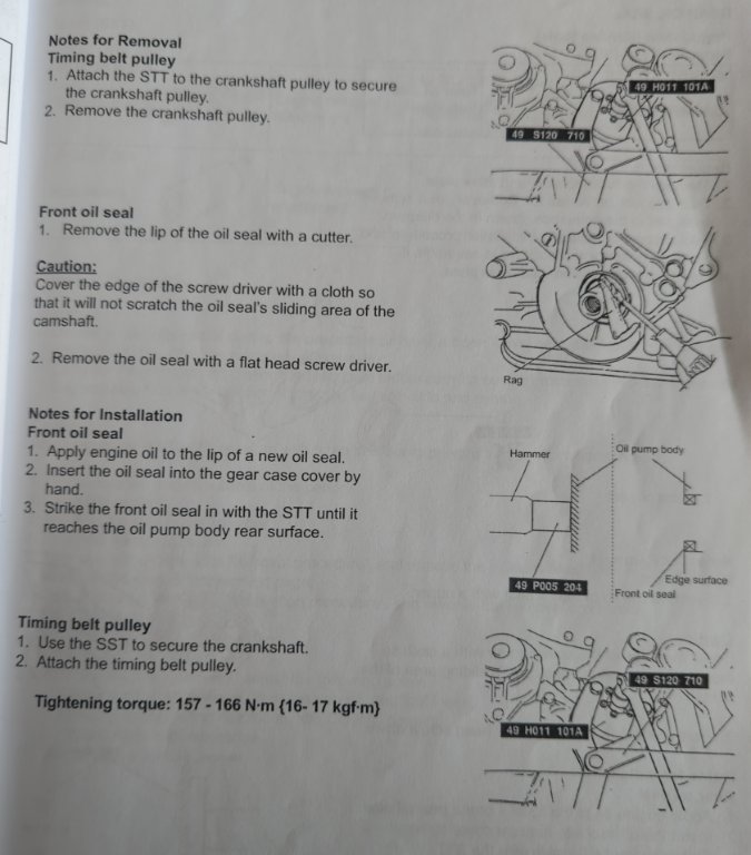

I’ve searched & searched but cannot find a figure for the torque setting for a camshaft pulley bolt on my 2006 2.0l petrol Bongo…can anyone help please?

Just found this page but it only covers the Crankshaft pulley not the Cam shaft ..... nothing I can see relates to the Camshaft ...

Thanks for that, I have that manual & also can’t find any reference to the camshaft bolt but have since been told that its 47-65Nm!
