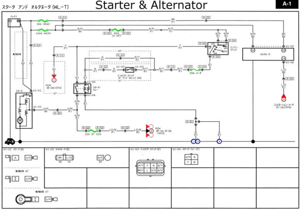

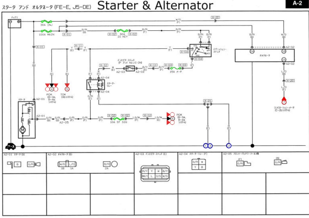

Good Morning All.
I have a problem with Starting the bongo, exactly as this thread describes.
viewtopic.php?p=606480#p606480
I to have for now fitted a pushbutton to the starter motor enabling me to crank the engine and when i do this she runs with no issues.
Does anyone know of any possible fixes. Starter motor contacts have been changed. Is it a Soleniod issue? Ignition issue?
Cheers in Advance for any guidance.
Gaz
Posts: 10883
Re: No Start, No Crank, No click
Post by g8dhe » Wed Apr 10, 2024 11:39 am
Welcome aboard!
Which engine do you have ?
There are variations here are both;

Post by Garypnewman » Wed Apr 10, 2024 11:49 am
Cheers for the drawing, that'll give me something to start checking. I'm an Electrical Engineer by trade so hopefully should only blow some fuses once.
Gaz

Post by Garypnewman » Sun Apr 14, 2024 8:03 am
Geoff,
Thank you for the drawings. Are a bit of chasing it all came down to the cable connected to the solenoid. Big old air gap. New wire now in and all working.
Cheers again.
