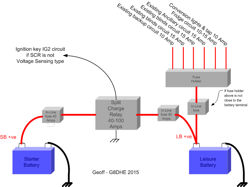

Most often its been bolted to the air scoop or a bit of plastic around the radiators, can be a small 1" cube or a larger VSR 4" cube, follow the two hefty cables back to each battery and there should be a fuse in each close to the battery. The one that feeds the LB sometimes will have a connection to the internal fuses on the relay side rather than the battery side and that's when confusion arises! Below is the right way to wire it.
