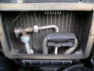

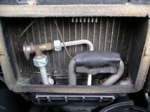

Your aware that the eye level vents won't blow hot air - to prevent you drying eyes out! The Windscreen and footwell vents are where hot air comes out. The front eye level vents will blow but never very hot air!
The other possibility is that the cooling matrix at the front that handles the incoming air from the fan can get badly clogged up and restricts air flow to the entire system, you need to remove the front fan under the bonnet and then it allows access to the cooling matrix (this reduces moisture level first, before it passes over the heating matrix) otherwise you end up with heated moist air that then condenses inside the cabin spreading moisture, however the moisture condenses on the cooling matrix and then turns to a solid mess blocking the matrix. You will need cleaning fluids, toothbrush and a gentle pick to remove all the muck, you have to work around the aircon thermostat and control parts!
