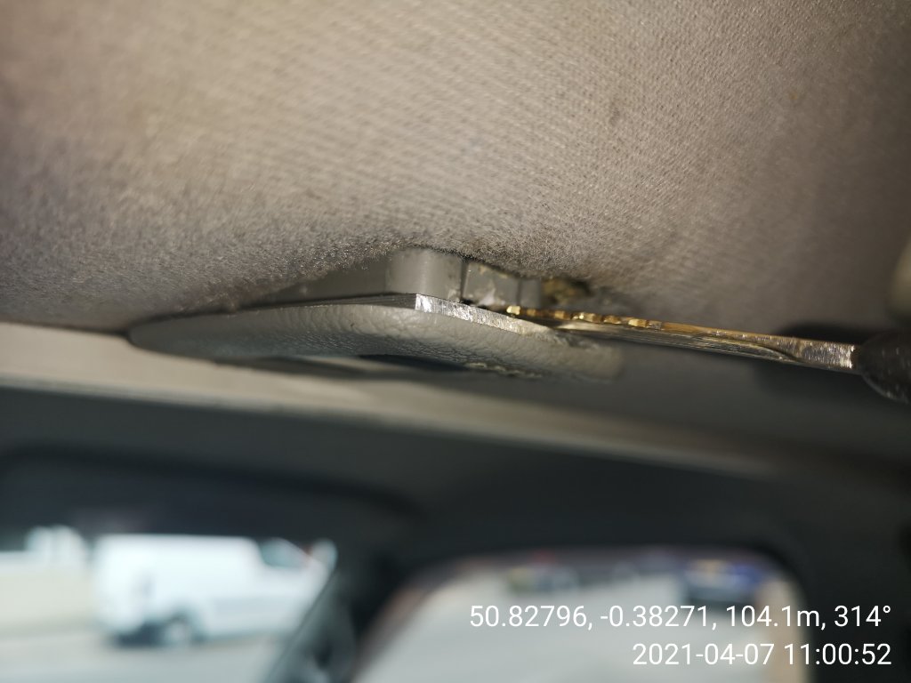

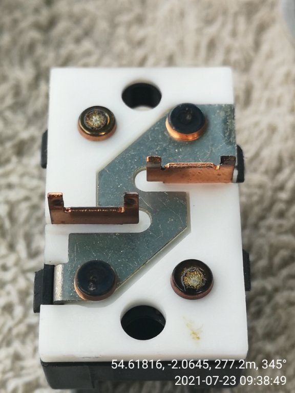

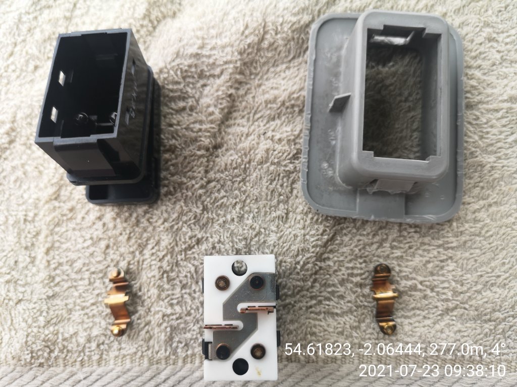

Have you tried cleaning the switch in the front cabin roof, that controls Up/Down ? The switches get very dirty!
To get it out using the ignition key to depress the tab on the surround
Then open up the switch
clean the contacts.

1 roof no is not a switch, beping sound gone when you press down - means is working (I cleaned just in case)
