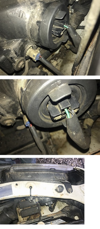

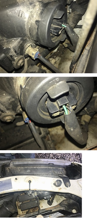

A simple question... one I didn't think I'd have to ask. How do you replace a headlight bulb of the sort pictured? It's not a conventional (older?) 3 metal pin + clip arrangement but a 3-pronged plastic mount.
I've pulled, twisted, squeezed, wiggled...
Suggestions welcome. Before I sledgehammer.
Thank you.
Mark

Yes it is a standard design, release the plug by squeezing the cross and the catch to remove, pull the rubber boot off then there is a fiddly wire clip that has to be released from a clip and the lamp pops out.
https://www.youtube.com/watch?v=xX89BN3Q_Us

Thanks-I’ll pull a bit harder… while squeezing.
