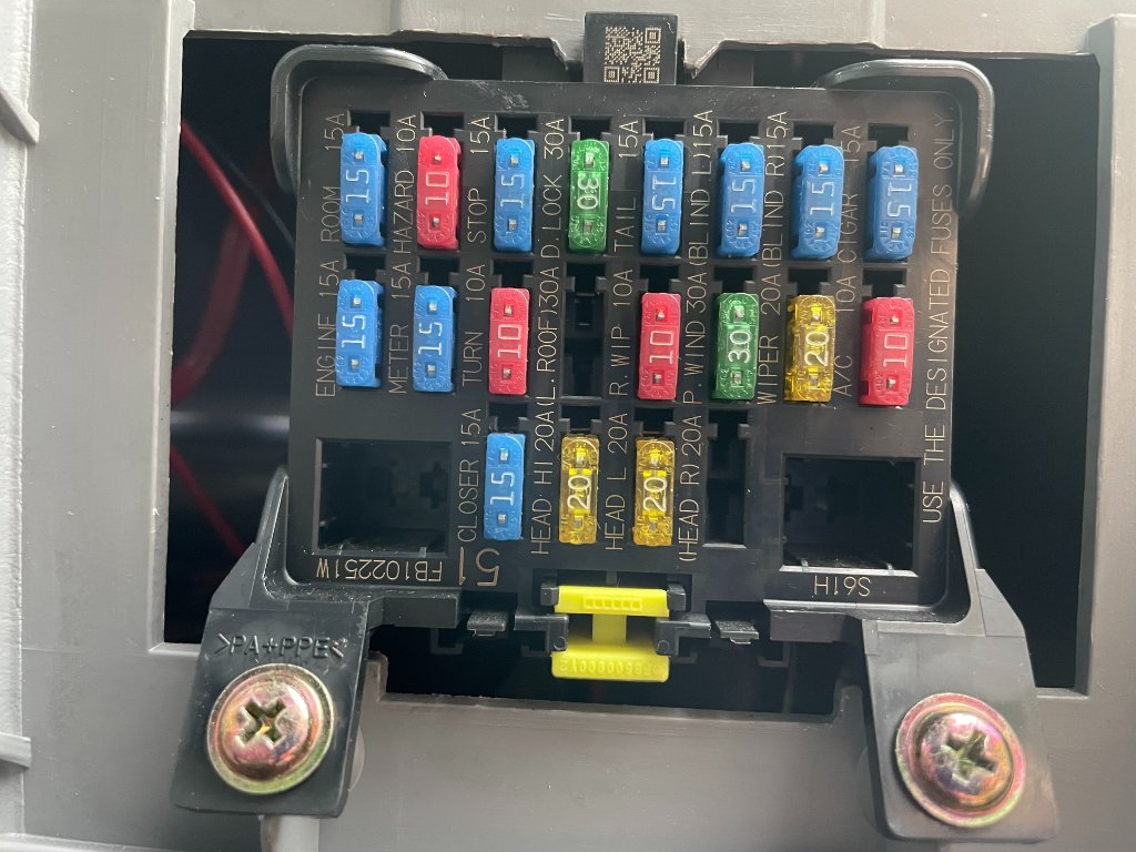

Hi everyone,
First time post after having our Bongo 'Bingo' since March '23.
I have been trying to diagnose an issue with our rear winder demister and having searched the posts on the forum, it led me to check the fuse which was conspicuous by its absence. I then searched which fuse was needed and believe I have noted it above but since then I have been unable to locate the correct one to purchase. I have tried a few times from different places but each time it arrives and does not fit. I have measured the aperture and this is roughly 12mm square, all the fuses that I can find are rectangular.
Hopefully they have come through, I have attached a photo of the fuse box showing the aperture for reference.
Our Bongo is a 2003 2l Petrol Aero City Runner.
Has anyone found where to buy these from? Or have I got this wrong and I should be buying a female version of this fuse?
Thanks in advance.

Post by g8dhe » Thu Jan 11, 2024 11:29 pm
All electrical info here - http://www.g8dhe.net/bwm/
Your looking for a J Series Female https://www.ebay.co.uk/sch/i.html?_osac ... s&_sacat=0

Post by BingoBongo28 » Fri Jan 12, 2024 7:30 am
That’s great thanks Geoff! Placed my order so should be here next week.
