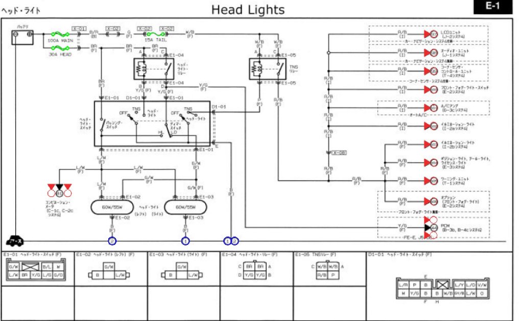

The Blue light only shows when your on Highbeam, not when the mainbeam is powered. On the diagram below the Highbeam light is connected on the (31) tab link, there isn't a mainbeam light at all on the dashboard.
